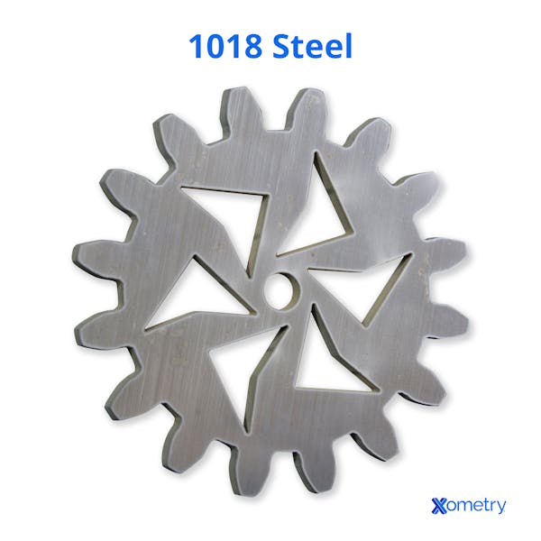

1018 steel gear
1018 steel gear
Uses for Machinery Components
1018 steel tends to produce continuous, stringy chips; tolerances can be maintained, but chip control may require tooling strategies. Machinists rely on 1018 steel for shafts, pins, gears, and spindles, where dimensional accuracy defines performance. 1018 steel supports high-speed machining without excessive tool wear. Engineers select 1018 steel when repeatable dimensions and surface finish matter. 1018 steel responds well to carburizing, which increases surface hardness while the core remains tough.
