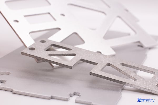

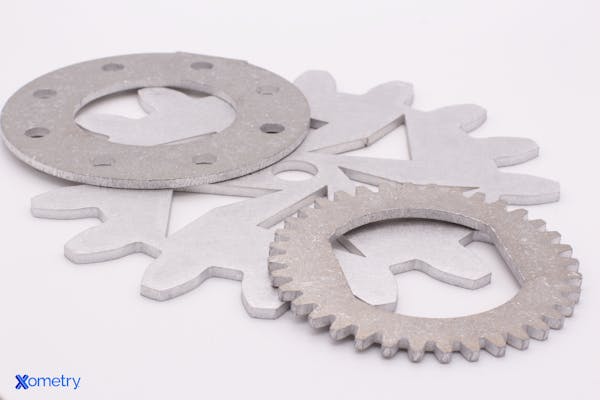

Aluminum sheet metal manufactured by Xometry
