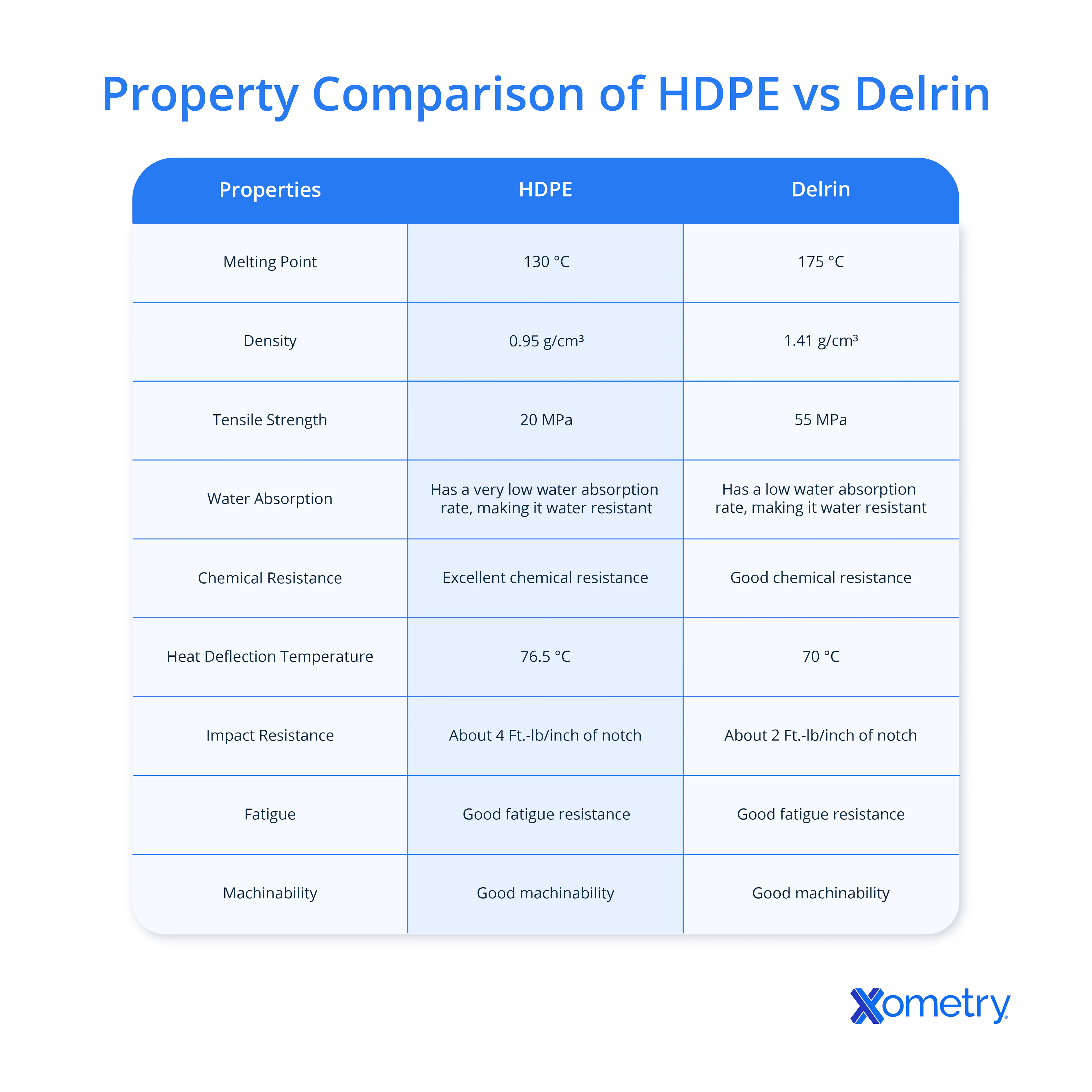

HDPE vs. Delrin: Physical Properties
Table 1 below compares the properties of HDPE and Delrin:
HDPE vs. Delrin properties
Chart representing properties of HDPE vs. Delrin

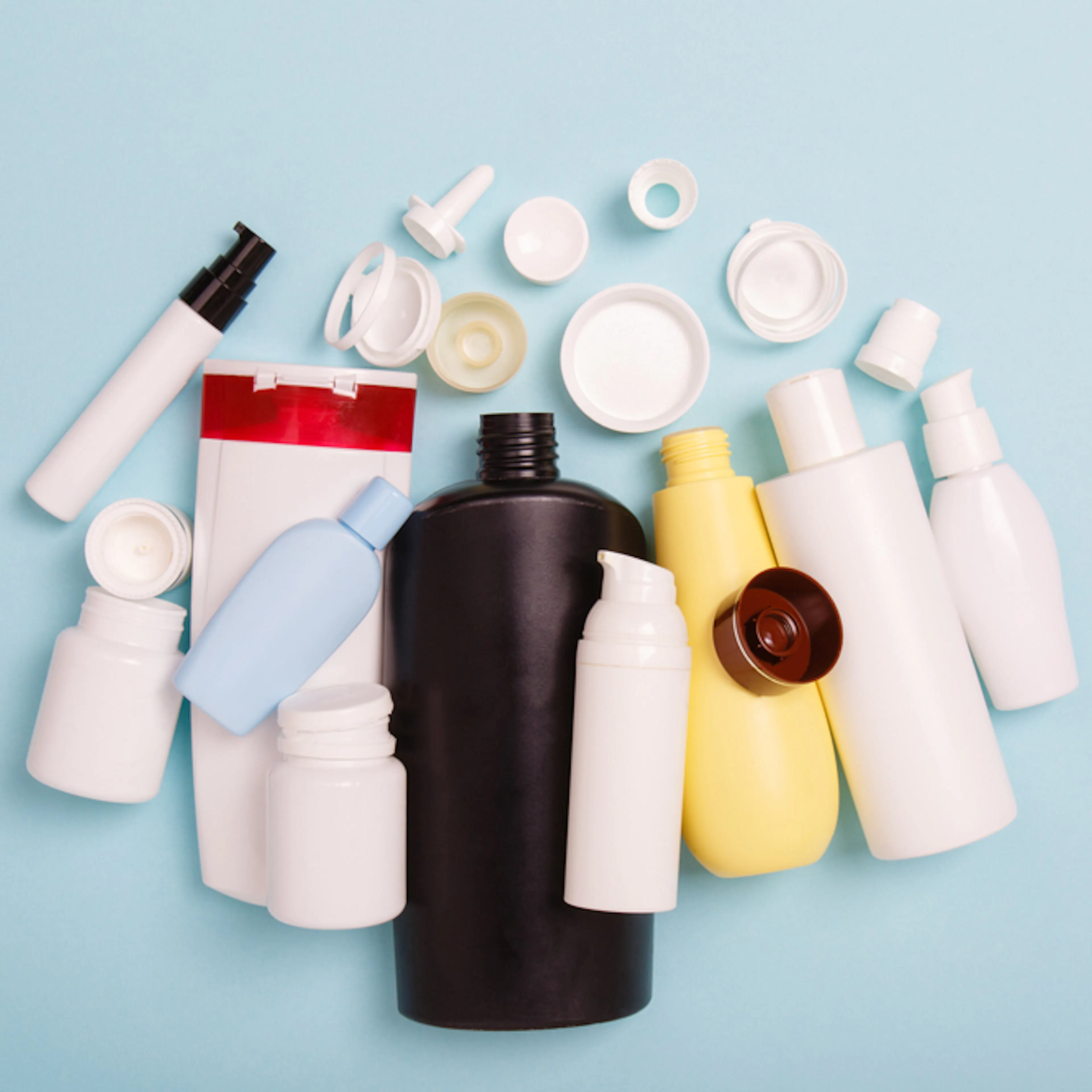

Both  HDPE and Delrin can be recycled. However, they are both petroleum products — making them non-renewable and ultimately unsustainable. HDPE is the most widely recycled plastic in the world, as it is one of the easiest types of plastic to recycle. HDPE can be recycled up to ten times, making it an ideal choice for applications requiring large quantities of material. It is often used in the manufacture of products such as pallets, fencing, and crates. Recycled HDPE can also be used to make plastic lumber, which can be used in many different applications. HDPE is also frequently used in the production of textiles and carpets, as well as recycled plastic bags. Figure 1 shows examples of recyclable products made with HDPE:
HPDE Bottles
Examples of recyclable products made with HDPE.
