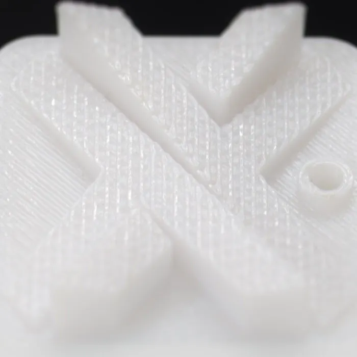

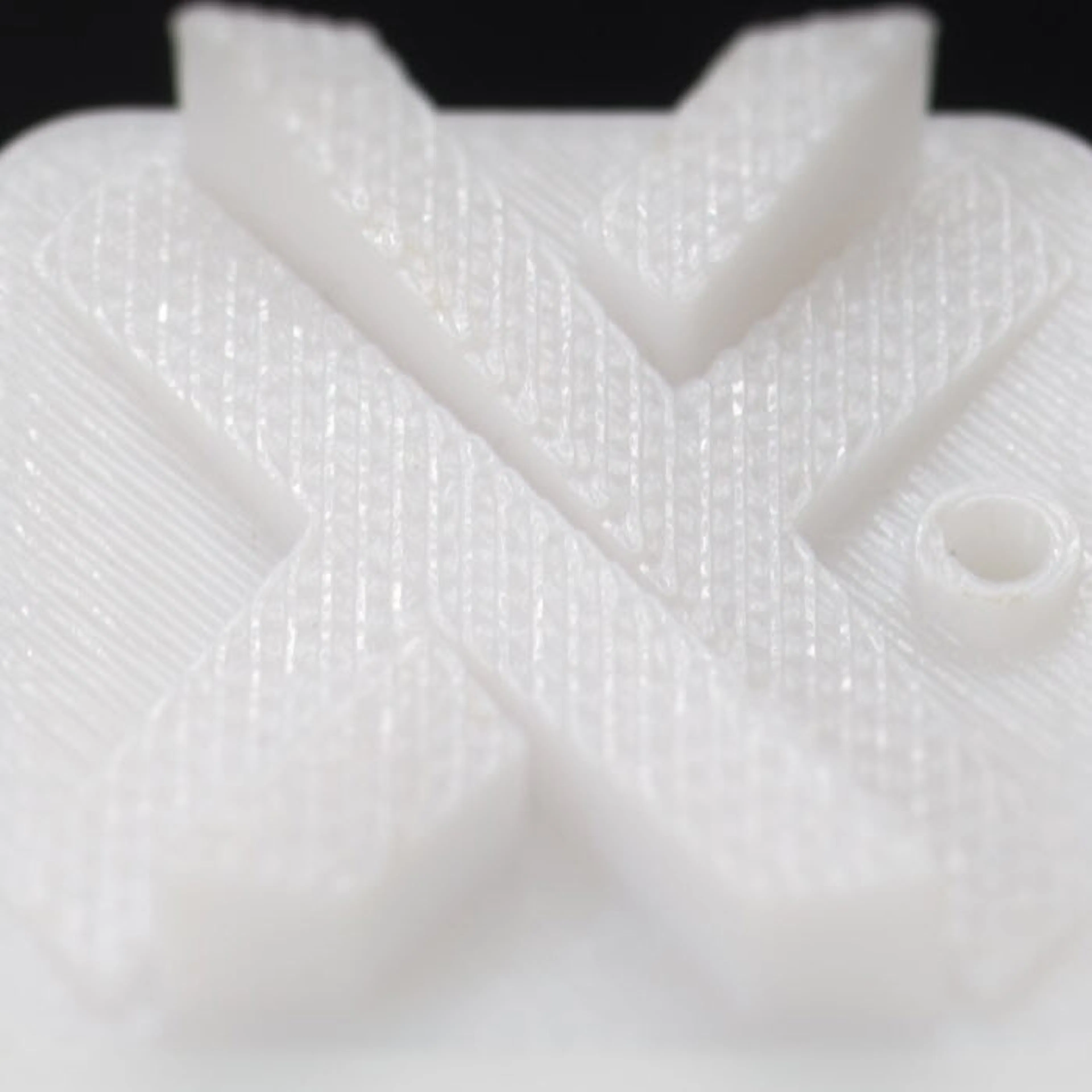

In the picture below, you can see an example of our Xometry logo that’s been 3D printed with polycarbonate.
Polycarbonate 3D printed part made by Xometry
