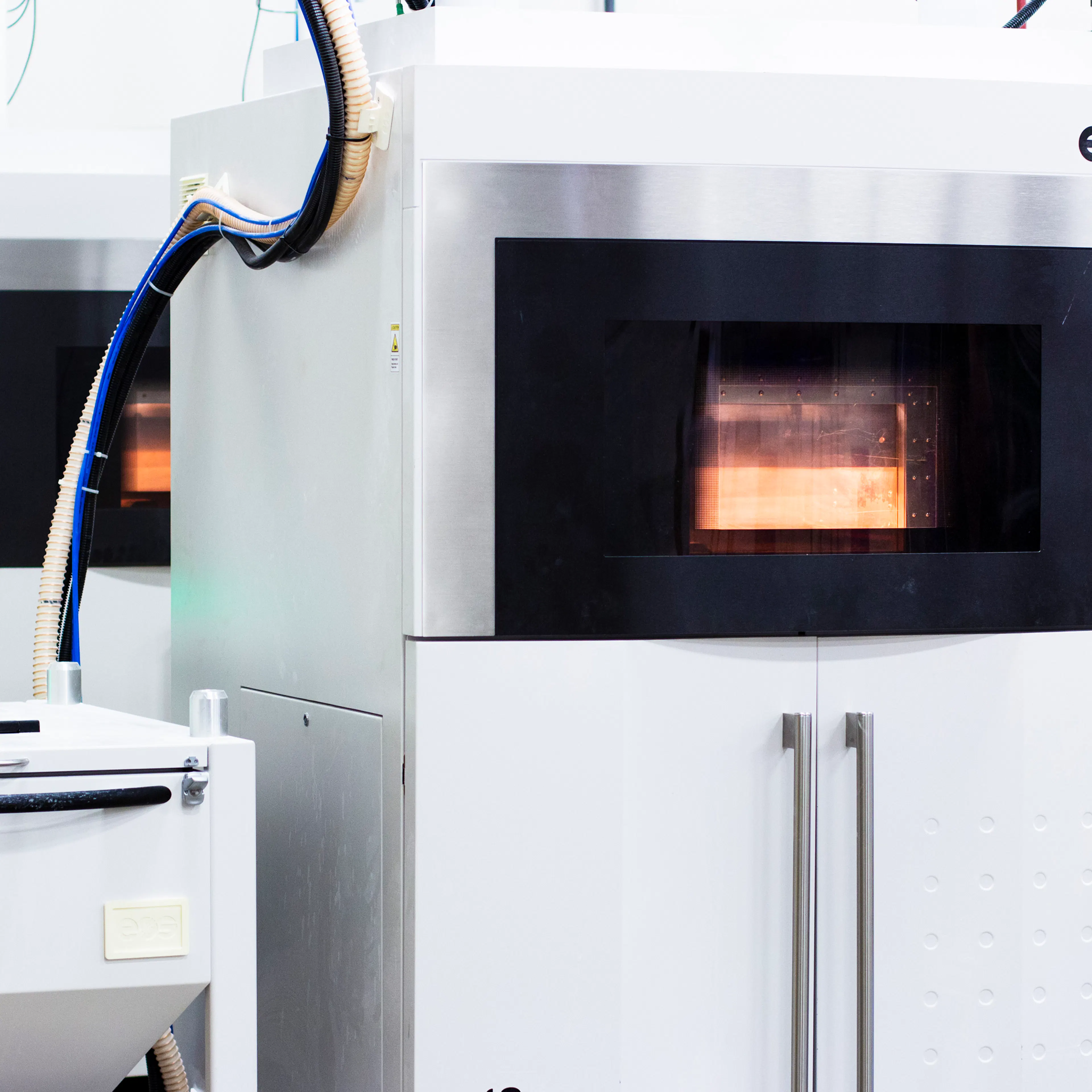

An SLS 3D Printing Machine at Xometry
SLS and SLA do have a few similarities; they’re both 3D printing methods, and they both use lasers. But the way they work, how much they cost, and their capabilities differ quite a bit. If you’re not familiar with either (or both) of these options, read on to learn all about them, how they work, and the ways in which they are different.

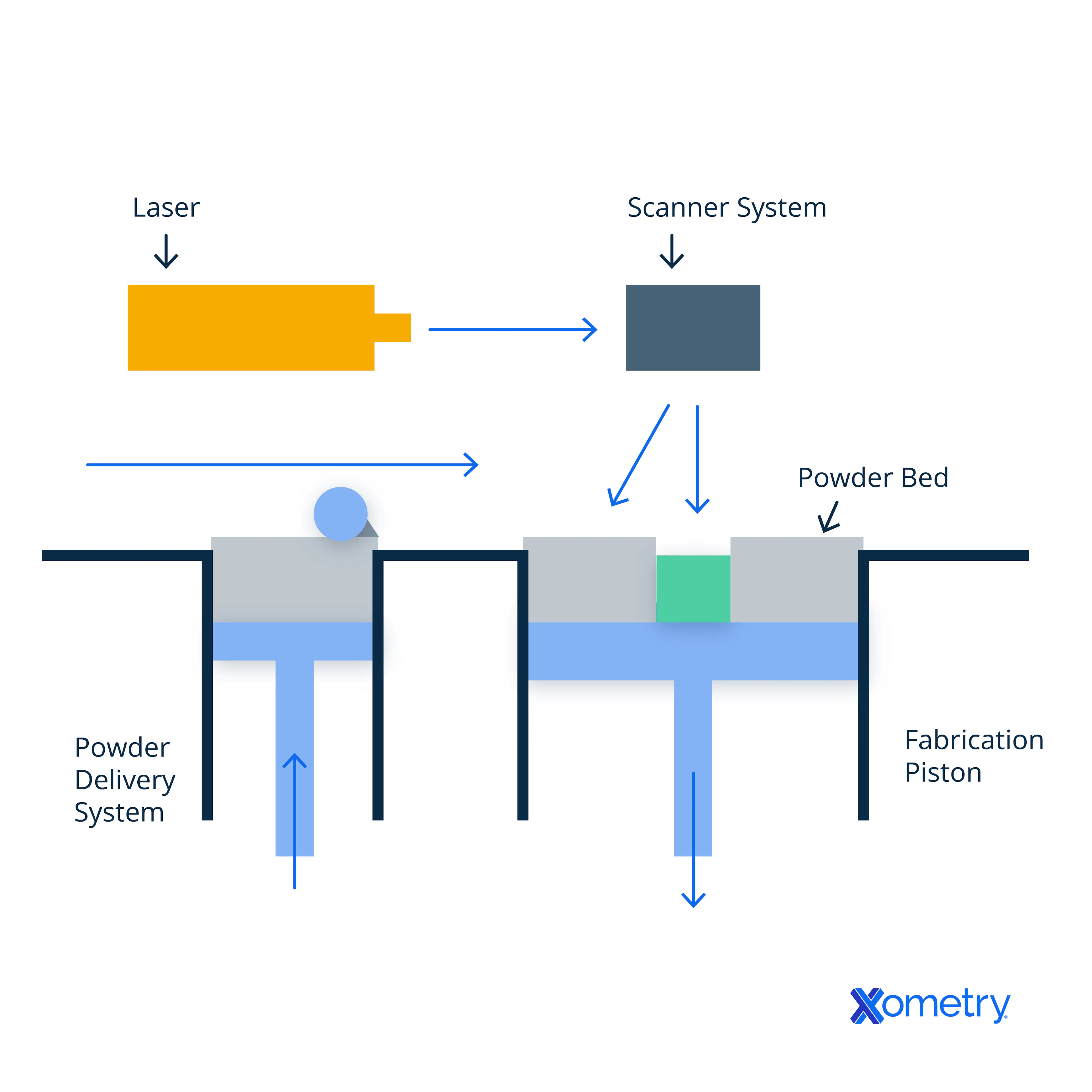

SLS (selective laser sintering) is a type of 3D printing invented in the ‘80s by Drs. Deckard and Beaman at Austin’s University of Texas. An SLS 3D printer makes solid parts by fusing powdered particles (like plastic, metal, glass, or ceramic) together with a powerful laser. While most SLS machines use nylon- or polymer-based materials, more high-end machines can work with materials with higher melting points. You can see how this machine is made up in the below image.
Diagram of an SLS 3D printer.
An SLS printer takes a digital design made on a computer and turns it into a physical model by first breaking it into 2D slices and then tracing them out individually. It then bonds the powder when necessary. It will then add more powder after each layer and the whole process repeats. Parts made with these printers are known for being tough, with great mechanical properties, but since the machine needs to be completely shielded and closed up during printing, you likely won’t be able to see your print until it’s finished. Here’s an example of an SLS-made part:

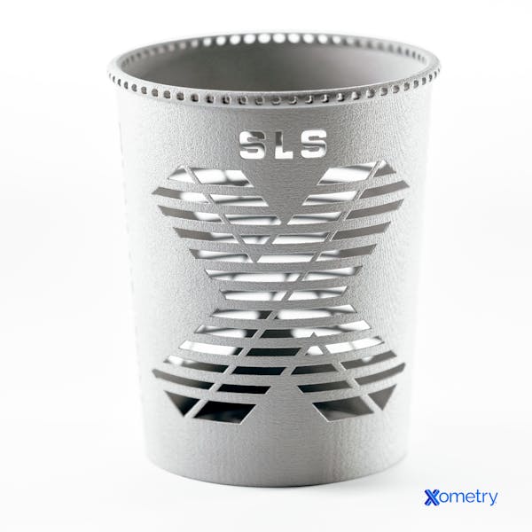

Pen holder made with SLS printing
Another advantage SLS offers is that you don’t need any support structures during printing—the surrounding powder can actually provide support for any overhanging parts. A lot of our customers use it for their time-sensitive projects as it’s very quick. If you’re interested in buying one of these printers for your business, prepare to make a substantial investment. SLS machines are not only expensive to buy, but they also use up a lot of electricity, racking up those utility bills. You’ll also want to make sure you’ve got enough space in your office or lab for them as they’re on the bulky side.

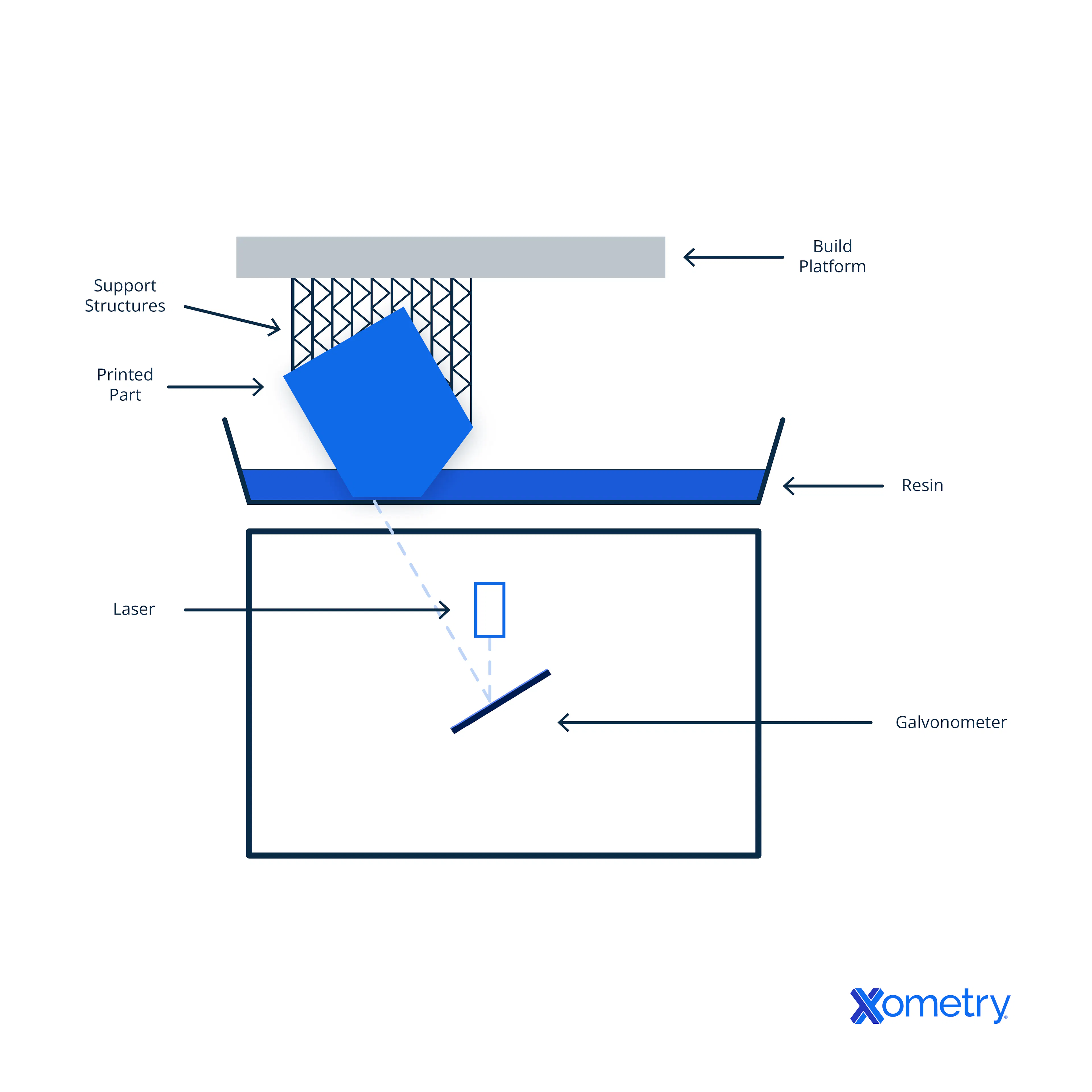

SLA, an abbreviation for stereolithography, is also a form of 3D printing that’s considered the oldest around. Invented in 1986 by 3D Systems’ founder Chuck Hall, SLA builds parts in a more peculiar way… upside down. It uses a type of laser, but this time it’s an ultraviolet laser that cures photosensitive resin into whichever shape you’ve chosen. While it prints, the build plate is always in contact with the resin tank. The laser points at specific parts until they’ve solidified, and then the plate raises out of the reservoir so the next layer can be cured. As this happens, each layer fuses with the one prior, and the whole process almost looks like the part is rising out of the liquid. You can see how these printers work in the following image:
SLA 3D printing
SLA 3D printing
Around six years after it was initially introduced, the printer got a big upgrade that made it capable of printing more complex parts and much more quickly. It’s still used today, especially when tight tolerances are needed. SLA printers can make parts with great resolution and surface finishes (like injection-molded parts), and they’re much smaller than SLS machines and can fit on an average desk. Their small size does mean that they’re not able to print larger parts like an SLS printer.
