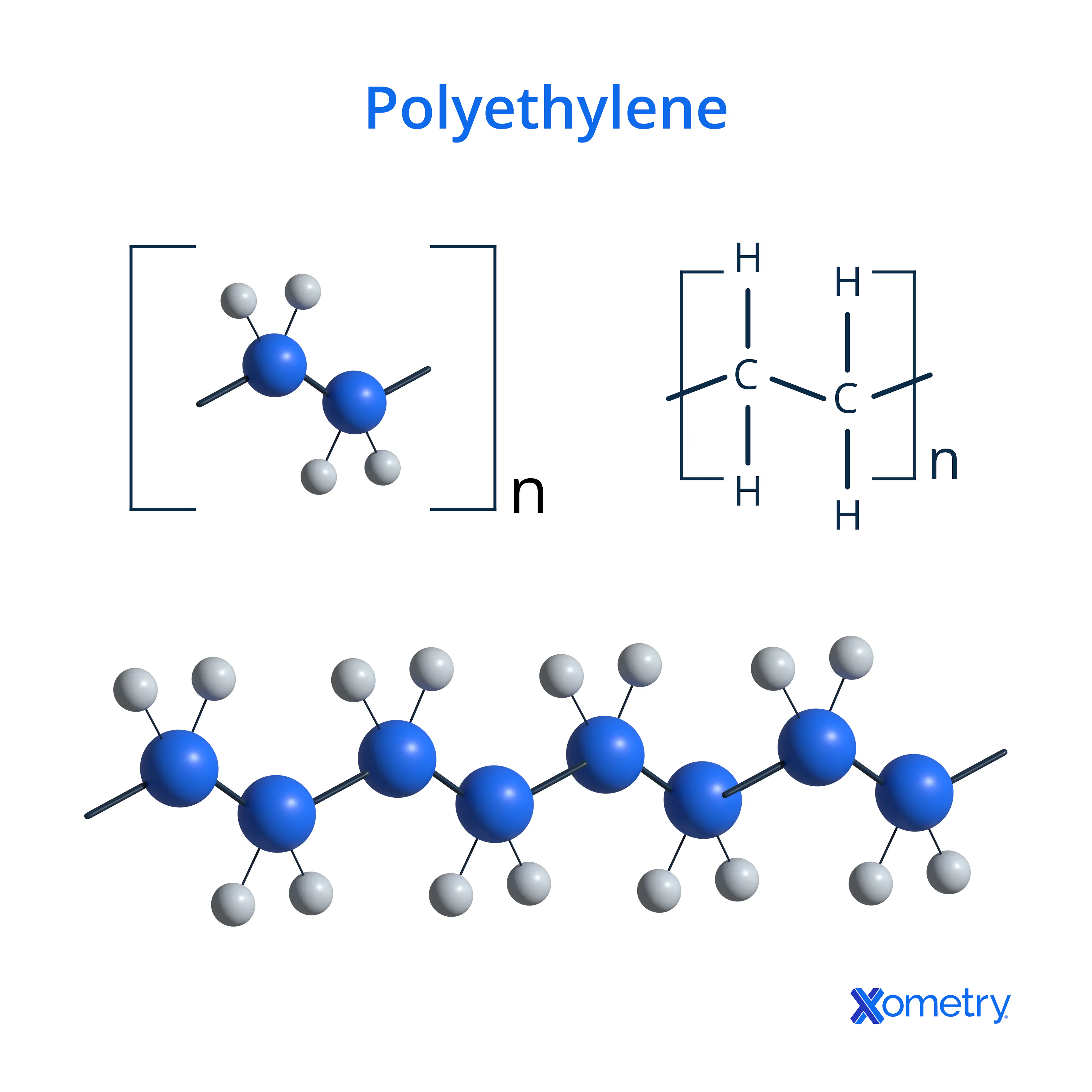

What Is Polyethylene?
Polyethylene (PE) is a thermoplastic polymer made from ethylene gas. It is chemically identical to HDPE in that it is formed from long chains of CH2 but differentiated by the regularity and size of side branches of shorter or longer chains of CH2 monomer. The side branches are randomly orientated and can be extensive, making networks of attached chains. PE should not be confused with Linear Low-Density Polyethylene (LLDPE) which is characterized by frequent, randomly oriented side branches of a single CH2 monomer.
The effect of the extensive side branching present in PE is to force greater distance between chains, which reduces the density and increases the potential for chains to tangle, pushing them further apart. The reduced density compared with HDPE makes PE a softer and weaker material, but more elastic and more resistant to shock loading. Typical PE densities are between 0.915 and 0.926 g/cm3. For more information, see our guide on PE material.
