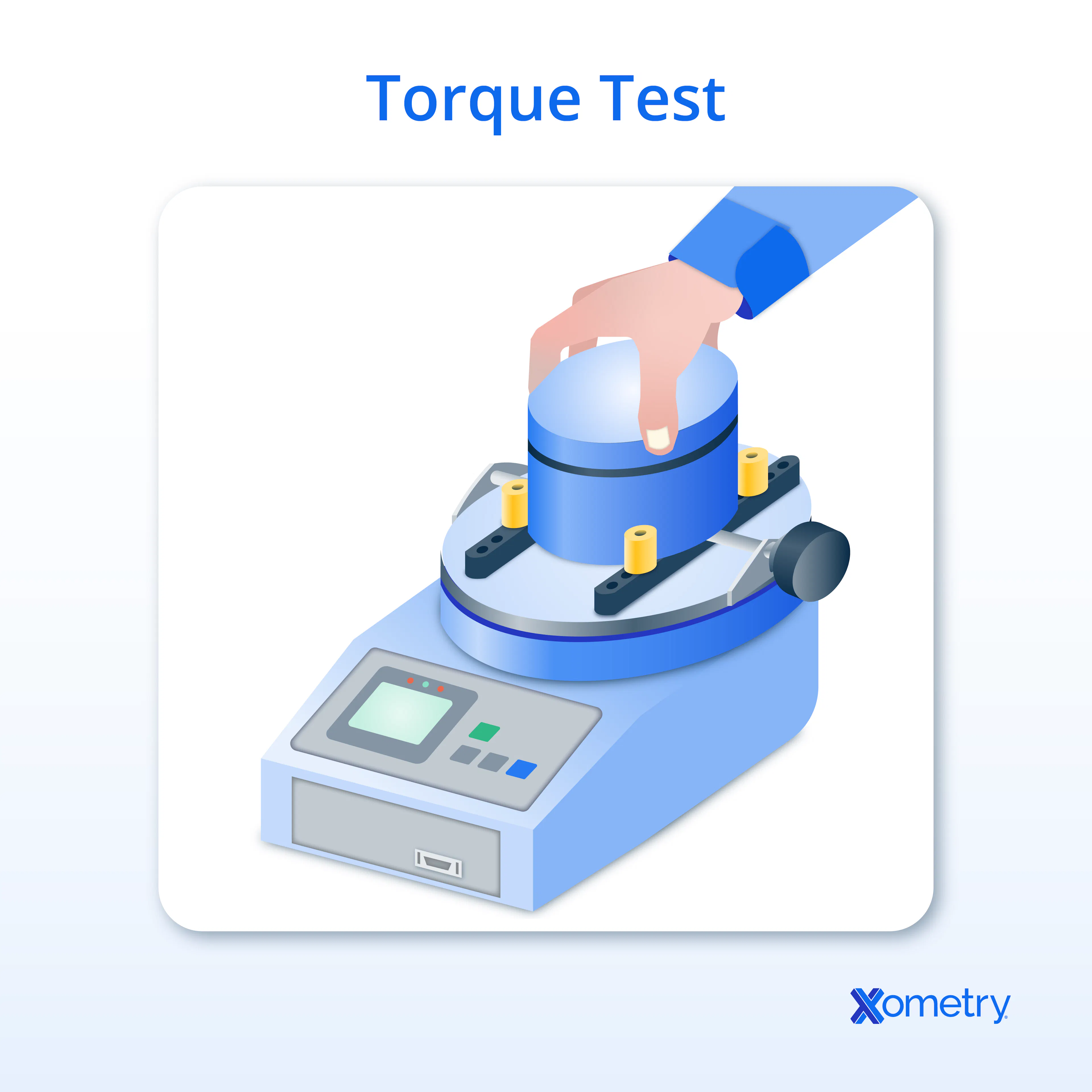

A torque test is a measure of an object’s reaction to applied rotational force. Torque tests come in different forms, some mild and some excessive. These include: static, dynamic, destructive, and non-destructive torque testing.
An illustration of a torque test.
