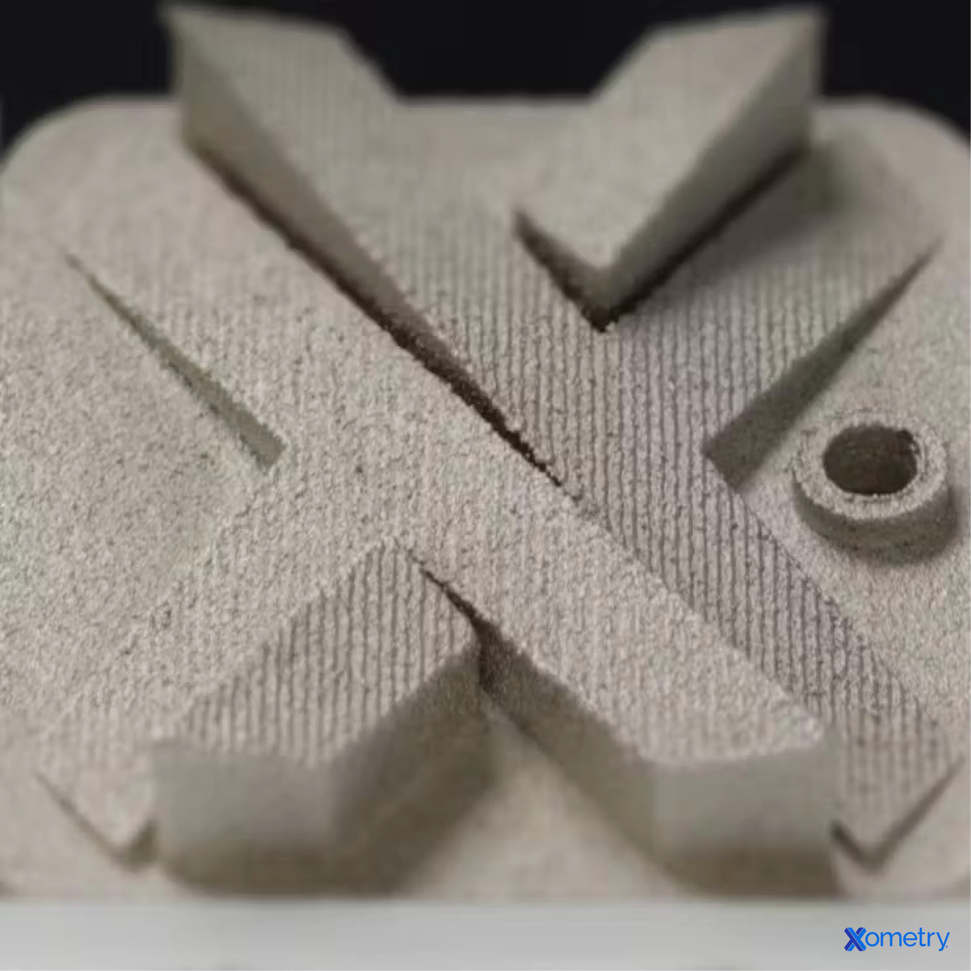

Its name gives a pretty good idea of what SLS does. It uses a laser to sinter powder together into a layer and repeats this process until the full design is finished. This type of 3D printing came out of the University of Texas in the 1980s, but the patent has since expired, meaning that it’s a technology option many companies have redeveloped and lessened the price of.
To create parts with SLS, a CO2 laser is programmed to sinter and fuse together a polymer-based powder until it forms a layer. It’ll then create another layer until your build is complete. Then, it’ll need a period to properly cool off (usually 12 hours at the very least) and time for blasting and finishing. You can see an example of a product we made through SLS in the photo below.
To learn more, see our full guide on What is SLS.
SLS Xometry part
An SLS part manufactured by Xometry
What are the Advantages of SLS Compared to SLM?
The advantages of SLS compared to SLM are listed below:
  1. SLS-printed parts have excellent mechanical properties.
  2. SLS easily makes complex-geometry parts since no supports are needed.
  3. SLS allows the recycling and reusing of unsintered powders.
What are the Disadvantages of SLS Compared to SLM?
The disadvantages of SLS compared to SLM are listed below:
  1. SLS printers have long lead times since only industrial-scale SLS printers are widely available.
  2. SLS parts commonly have poor and grainy surface finishes and may require post-processing to achieve desired surface finishes.
  3. Warping and oversintering can occur on large, flat surfaces and small holes in SLS-printed parts.

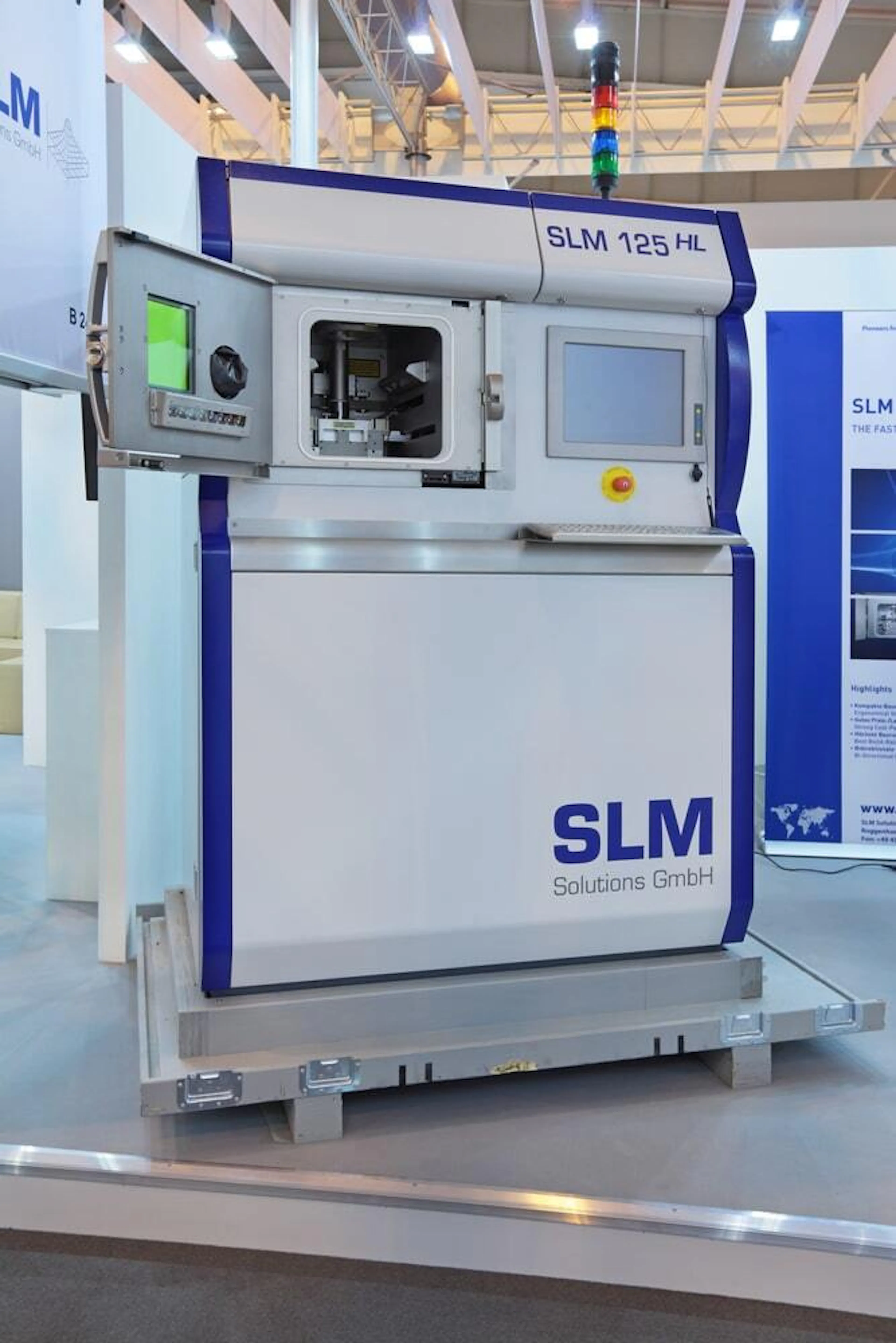

This kind of 3D printing method came to be in the early 21st century from Fraunhofer Institute in Germany. SLM also uses a high-powered laser on powders, but it melts it rather than sinters and works with metal powders instead of plastic ones. It builds up layers through additive manufacturing, too, and does so in a more controlled environment filled with inert gases like argon and nitrogen. Below, you can see a photo of an SLM printer.
slm 3d printer
A typical SLM 3D printer. Image Credit: Shutterstock.com/ID1974
What are the Advantages of SLM Compared to SLS?
The advantages of SLM compared to SLS are listed below:
  1. An extensive range of potential materials makes SLM a well-rounded, robust alternative to traditional metal-fabrication methods.
  2. SLM can reduce manufacturing lead times and tooling costs.
What are the Disadvantages of SLM Compared to SLS?
The disadvantages of SLM compared to SLS are listed below:
  1. SLM systems are expensive due to their costly technology and equipment.
  2. SLM requires extensive post-processing to achieve desired surface finishes.
  3. SLM requires increased material usage due to the need for support for overhangs on parts during printing.
