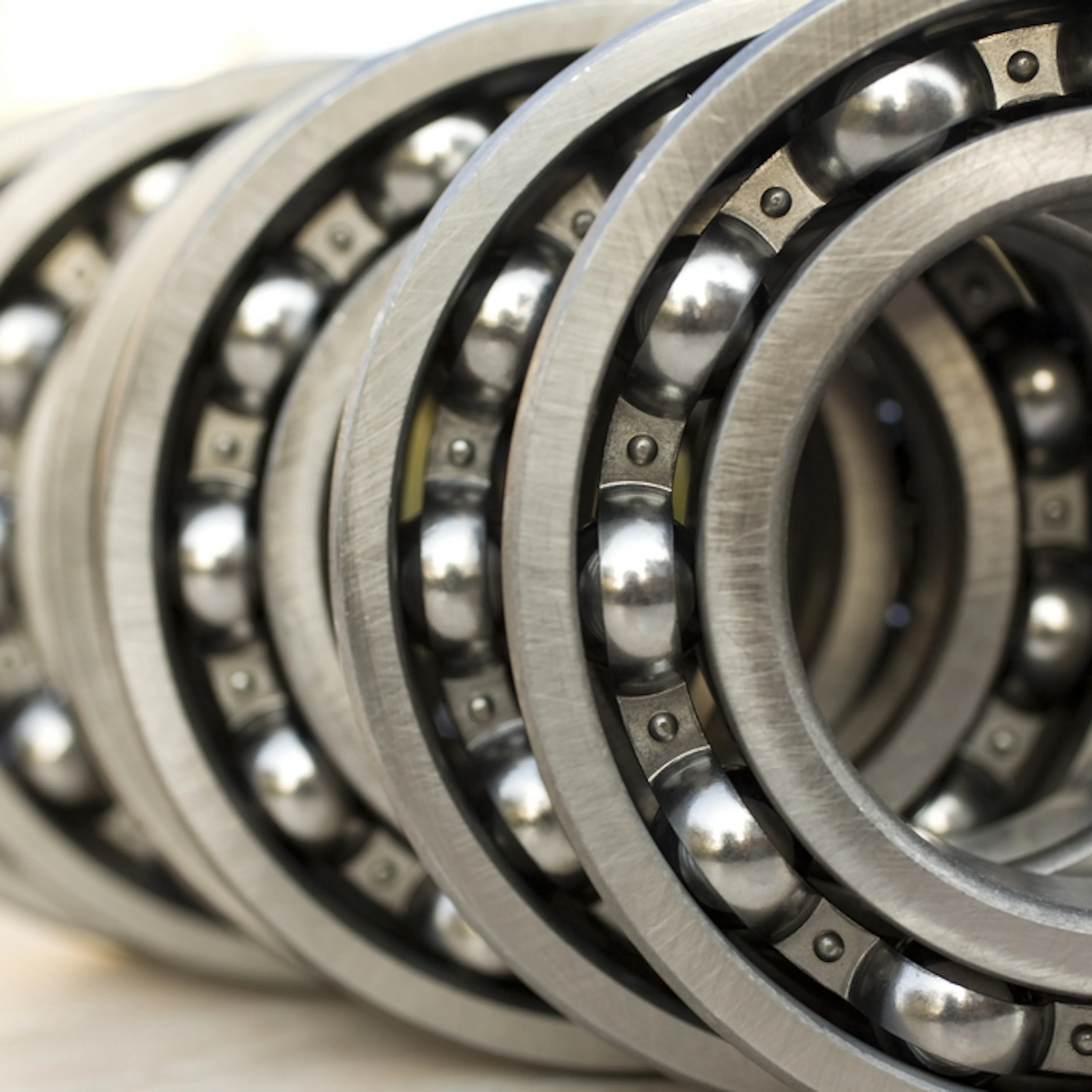

What Is 52100 Steel Used For?
52100 steel is primarily utilized in steel bearings and equipment made for bearing manufacturing. Here are several common applications where 52100 steel is used:
- Due to its high wear resistance and ability to retain lubricants, 52100 steel is extensively used in anti-friction bearings.
- The toughness and strength of 52100 steel make it well-suited for punches, taps, and dies, which are essential tools in metalworking and fabrication.
- The hardness and durability of 52100 steel make it suitable for mill rolls, which are used in various industrial milling processes.
- The hardness and strength of 52100 steel make it suitable for fasteners, such as bolts and screws, that need to withstand high loads and provide secure connections.
- 52100 steel finds applications in the production of automotive and aircraft components that must be strong, durable, and resistant to wear.

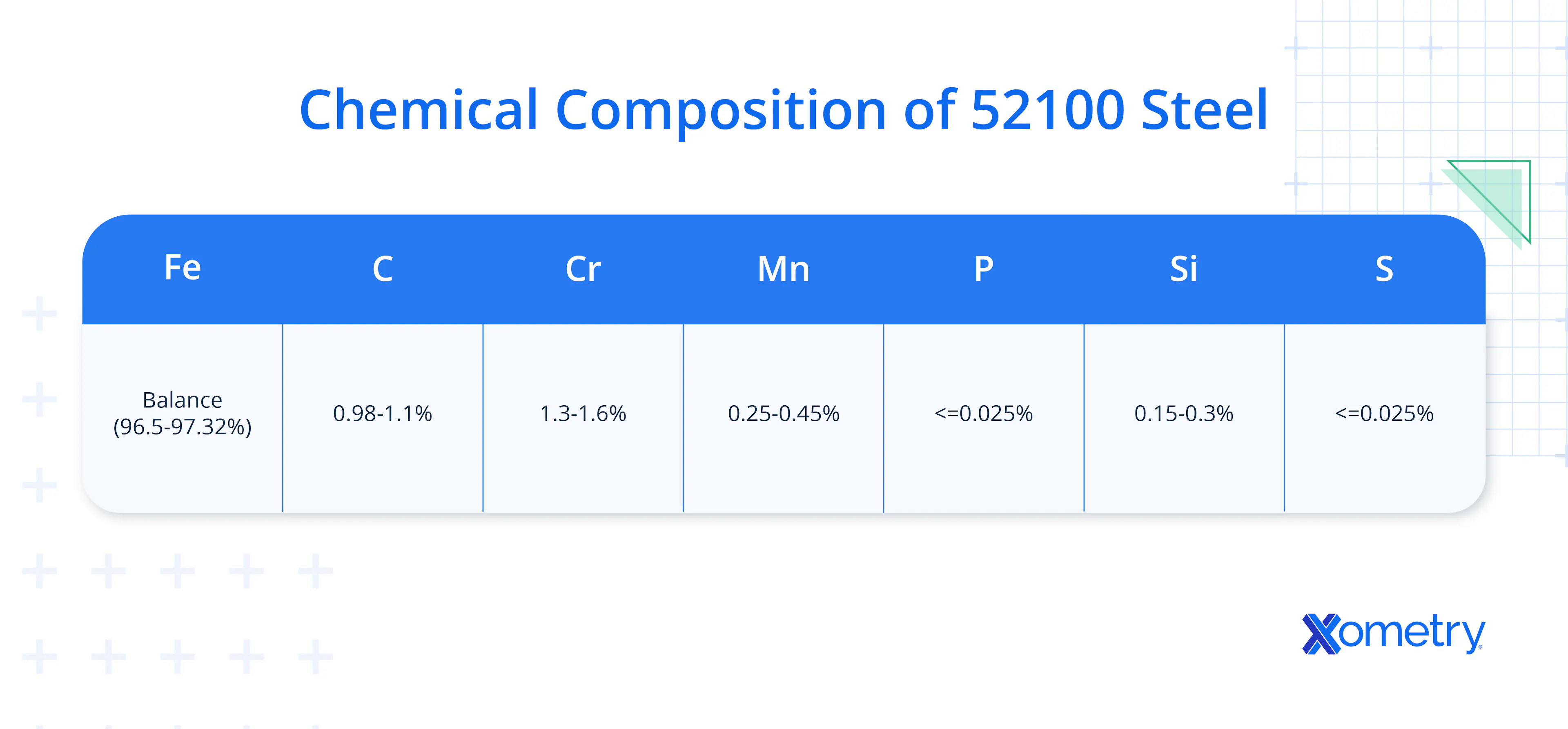

What Is the Chemical Composition of 52100 Steel?
The chemical composition of 52100 steel is outlined in Table 1:
Fe | C | Cr | Mn | P | Si | S |
Fe Balance (96.5-97.32%) | C 0.98-1.1% | Cr 1.3-1.6% | Mn 0.25-0.45% | P <=0.025% | Si 0.15-0.3% | S 0.03% |
Table Credit: https://www.azom.com/article.aspx?ArticleID=6704
What Is the Carbon Content of 52100 Steel?
The carbon content of 52100 steel typically ranges between 0.98% and 1.10%. This high percentage contributes to the steel's hardness, wear resistance, and ability to retain its shape under high-stress conditions. The precise carbon content may vary slightly depending on the specific manufacturing process and steel supplier, but it generally falls within this range.
