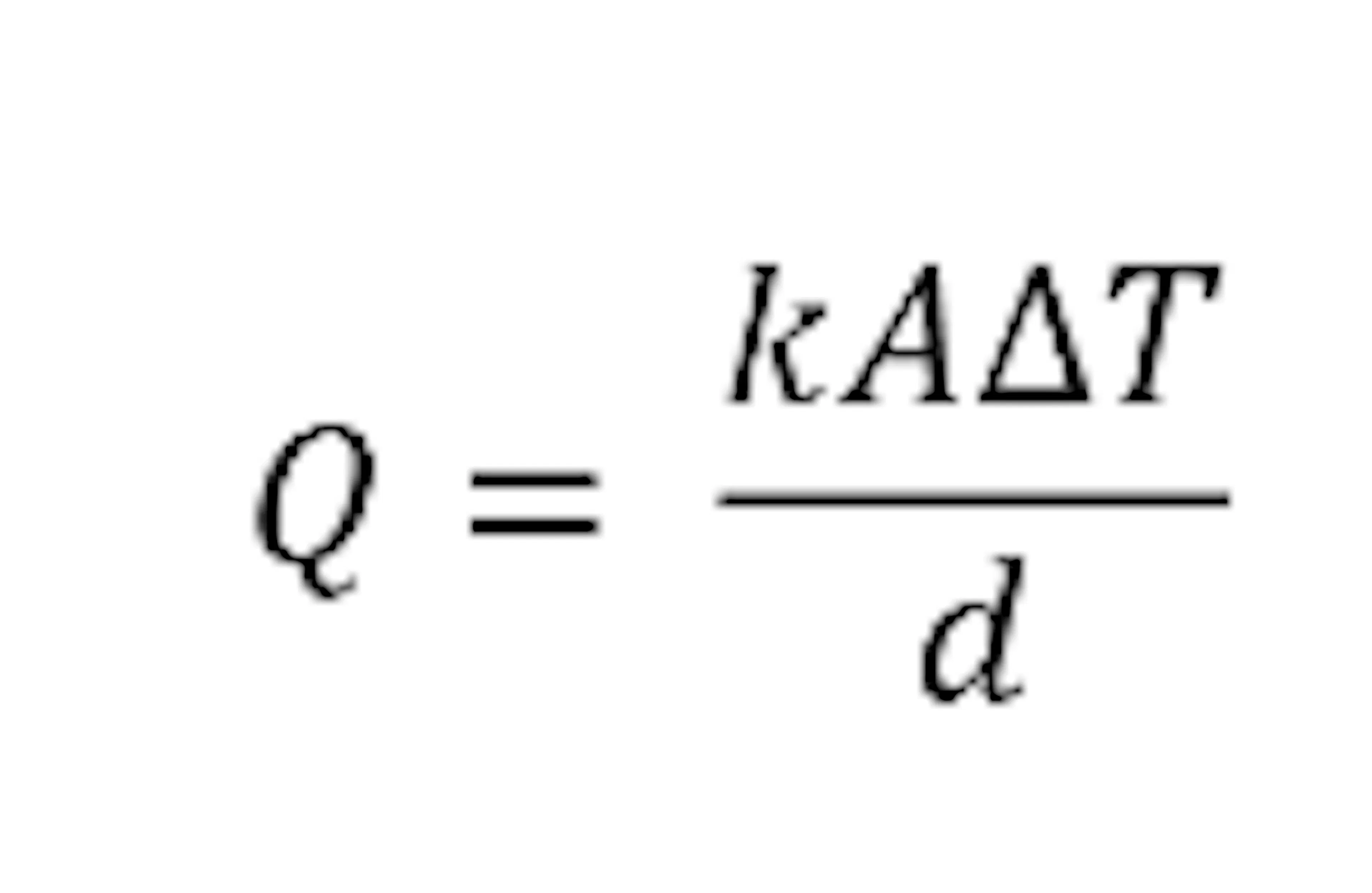

What Is the Formula for Thermal Conductivity?
Without further ado, let’s get straight to the formula for calculating thermal conductivity. First, you’ll need to know what all the symbols mean:
  • k = Thermal conductivity
  • Q = Heat flux
  • A = Cross-sectional area
  • ΔT = The difference in temperature of the material’s two sides
  • T1 = The material’s hot side
  • T2 = The material’s cold side
  • d = The length of the material
We’ll use a simplified form of Fourier’s law for heat transfer, but there are a few things to keep in mind with this law. If the temperature on the hot side doesn’t change, heat transfer can be classified as a “steady state,” and heat is only transferred in one direction. Also, the thermal conductivity value of a material will change depending on the temperature. As a general rule, the higher the temperature, the higher the thermal conductivity. So here it is:
heat transfer equation
Heat transfer equation.

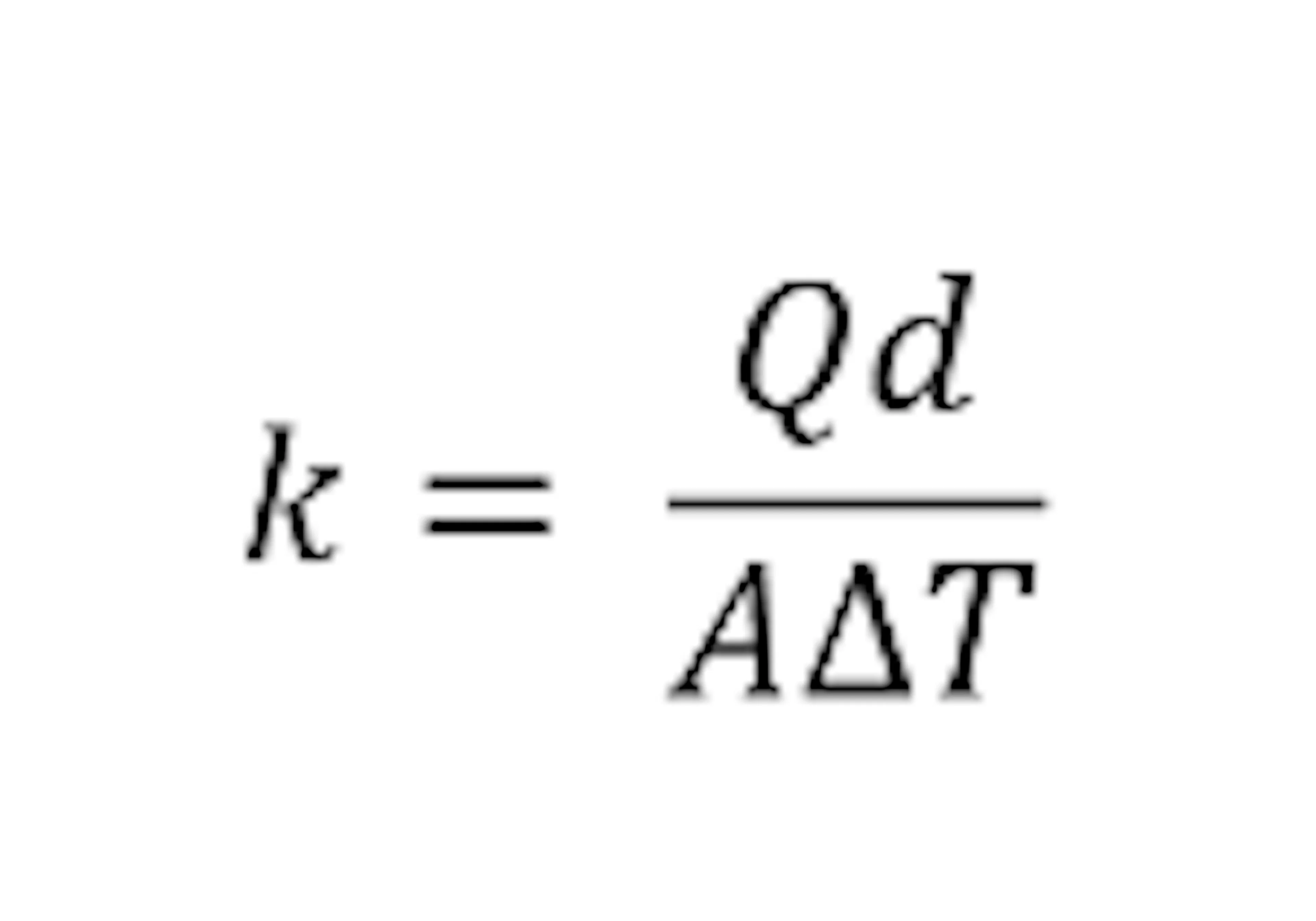

In this instance, the heat transfer is one-dimensional and in a steady state. We can also rearrange the equation, switching the value for thermal conductivity on the left-hand side. Here’s what the thermal conductivity formula would look like:
thermal conductivity equation
Thermal conductivity equation.
We wouldn’t recommend solely relying on this formula to determine a material’s thermal conductivity, though. The best way to do so is experimentally under controlled conditions, according to strict international standards. Most material data sheets will show thermal conductivity at specific temperatures, or even in a range of temperatures.

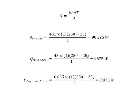

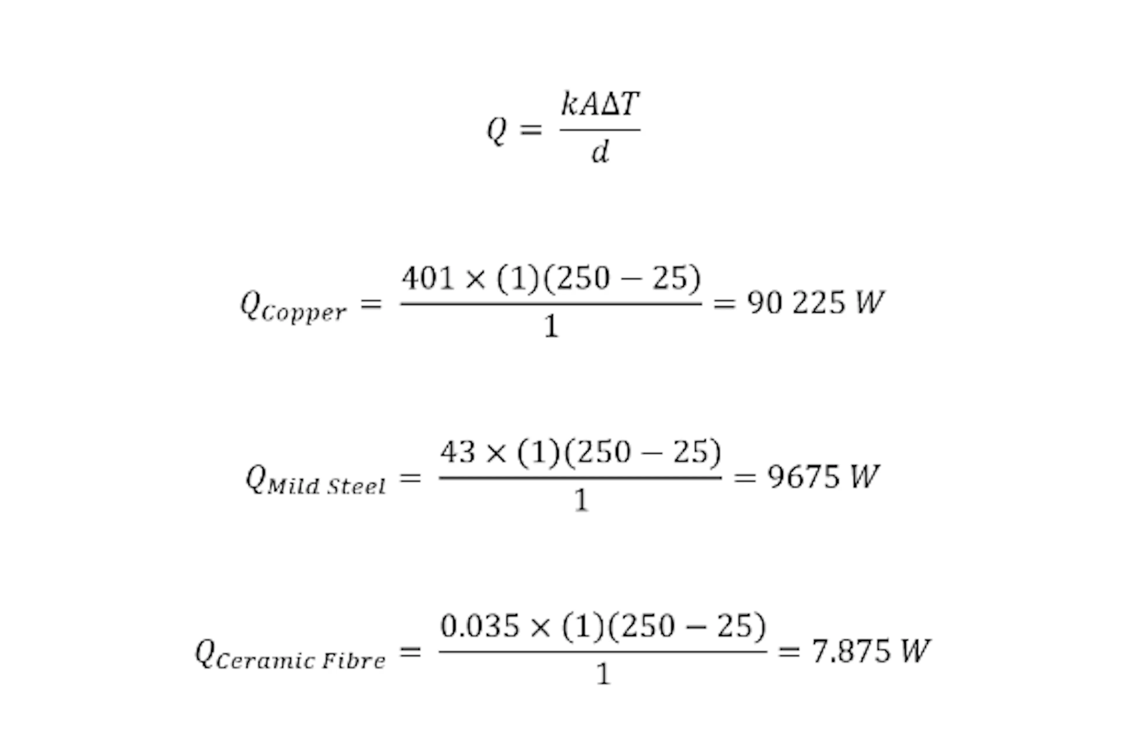

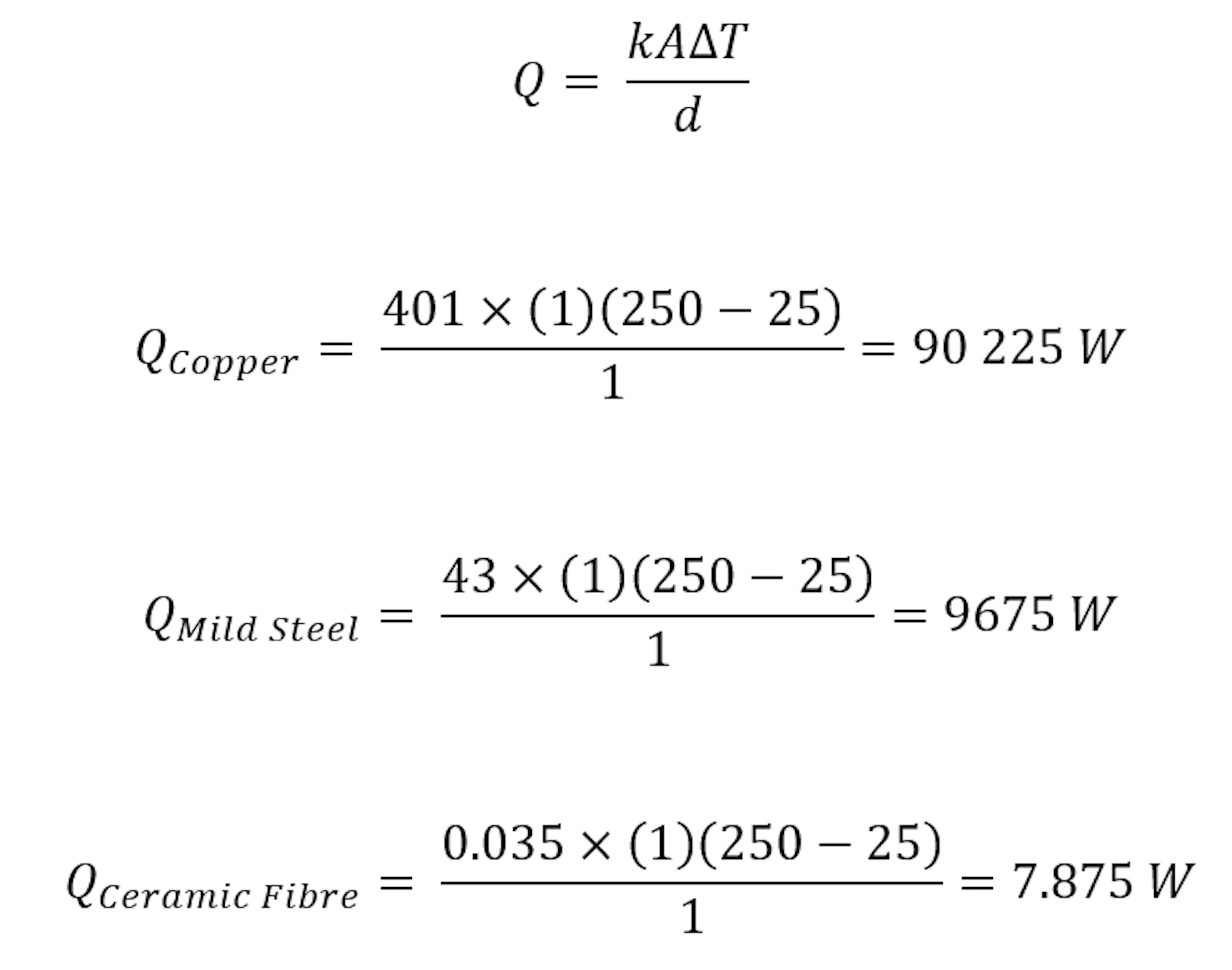

To illustrate the effect of a material’s thermal conductivity on the heat flux magnitude, below are three examples of thermal conductivities of common materials that have been experimentally determined. For these examples, the plate is assumed to be 1m thick with a length and breadth of 1m, T1 is equal to 250°C, and T2 is equal to 25°C.
thermal conductivity equations for common materials
Examples of thermal conductivity calculations for common materials.

What Are Examples of Calculating Thermal Conductivity?
Thermal conductivity is not calculated but determined via experimental means. However, to illustrate the effect of a material’s thermal conductivity on the heat flux magnitude, three examples are presented below using experimentally determined thermal conductivities of common materials. The plate is assumed to be 1 m thick with a length and breadth of 1 m, and T1 equal to 250 °C and T2 equal to 25 °C.
An example of calculating thermal conductivity
