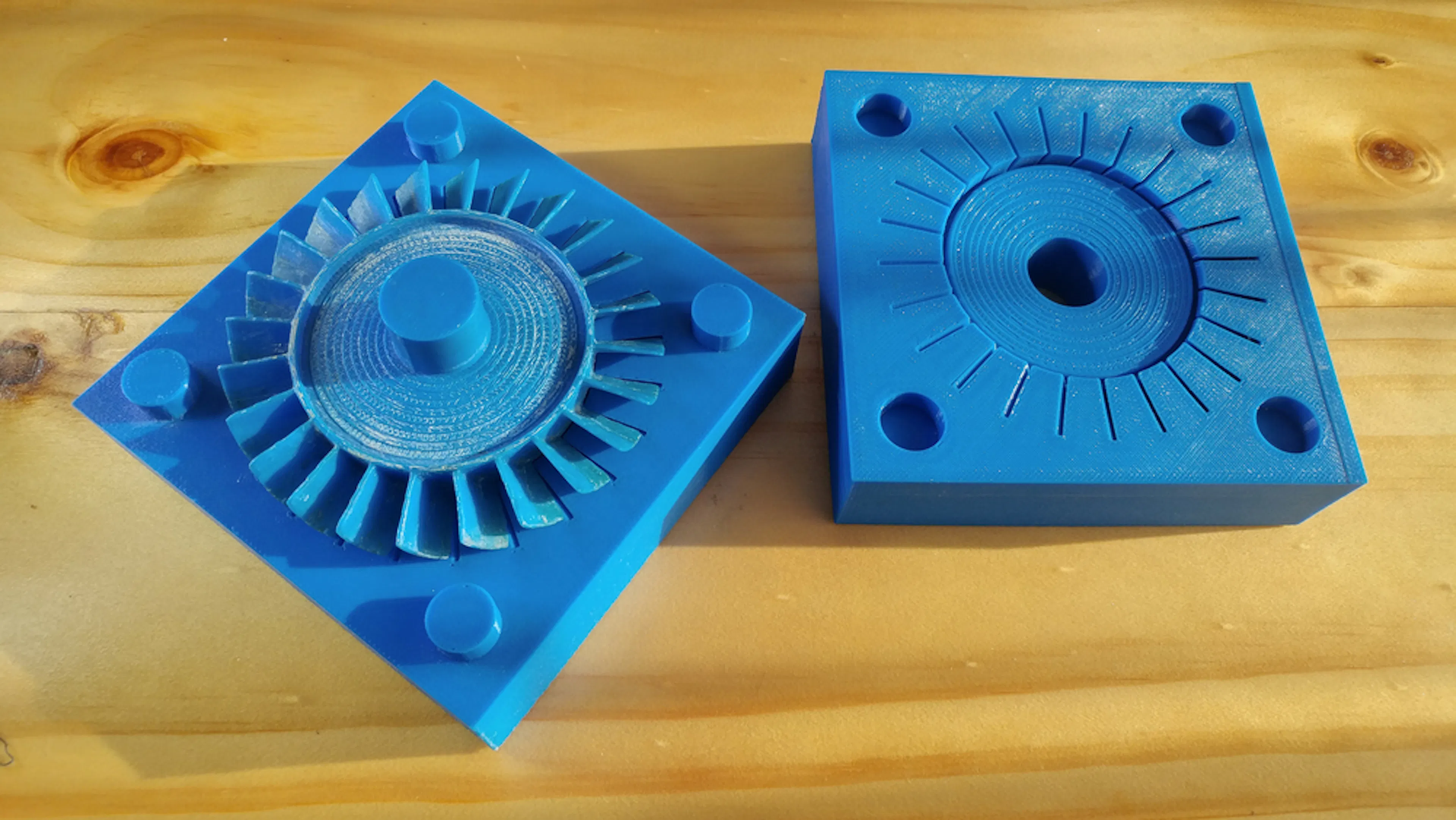

The success of the injection molding process depends largely on the quality of the 3D-printed mold, so there are a few things to keep in mind when you’re making it. Firstly, the mold material must be able to withstand high temperatures and pressure without warping or melting, so choose wisely. The mold’s design is equally as important. Uniform wall thickness helps prevent warping and defects, while avoiding sharp corners reduces stress points and improves durability. Gate location should be optimized to ensure proper material flow, and runner systems should be incorporated to prevent flash, or excess material escaping the mold. Tweaks like adjusting clamping force and injection pressure can further improve results.
Surface quality is also an important consideration. 3D-printed molds tend to have a rougher surface than aluminum or steel molds. This can impact the final product’s texture and may require post-processing to achieve a smoother finish. For parts requiring a high-quality surface, metal molds are the better choice. Refining the surface finish minimizes roughness and enhances part quality. Finally, draft angles of 1.5° to 2° make part ejection easier and prevent damage to the molded piece, improving both mold longevity and product quality. Before full production, the mold needs to be thoroughly tested and validated to find any design flaws or weaknesses so that you can make the adjustments before going ahead with production. You’ll also have to choose a mold that matches the scale of the part you want to make.
"Creating a 3D printed mold is a little bit of art and science. I typically rely on 3D printing for any of the organic or curved features, but may add metal machined inserts for anything that requires a long pull or is a narrow, delicate feature."
