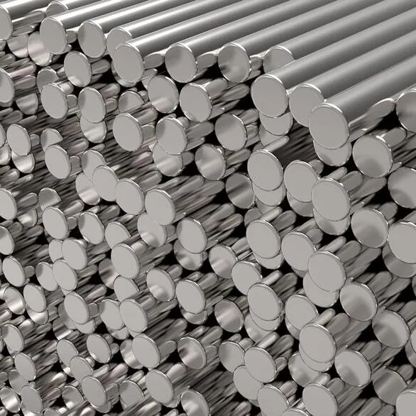

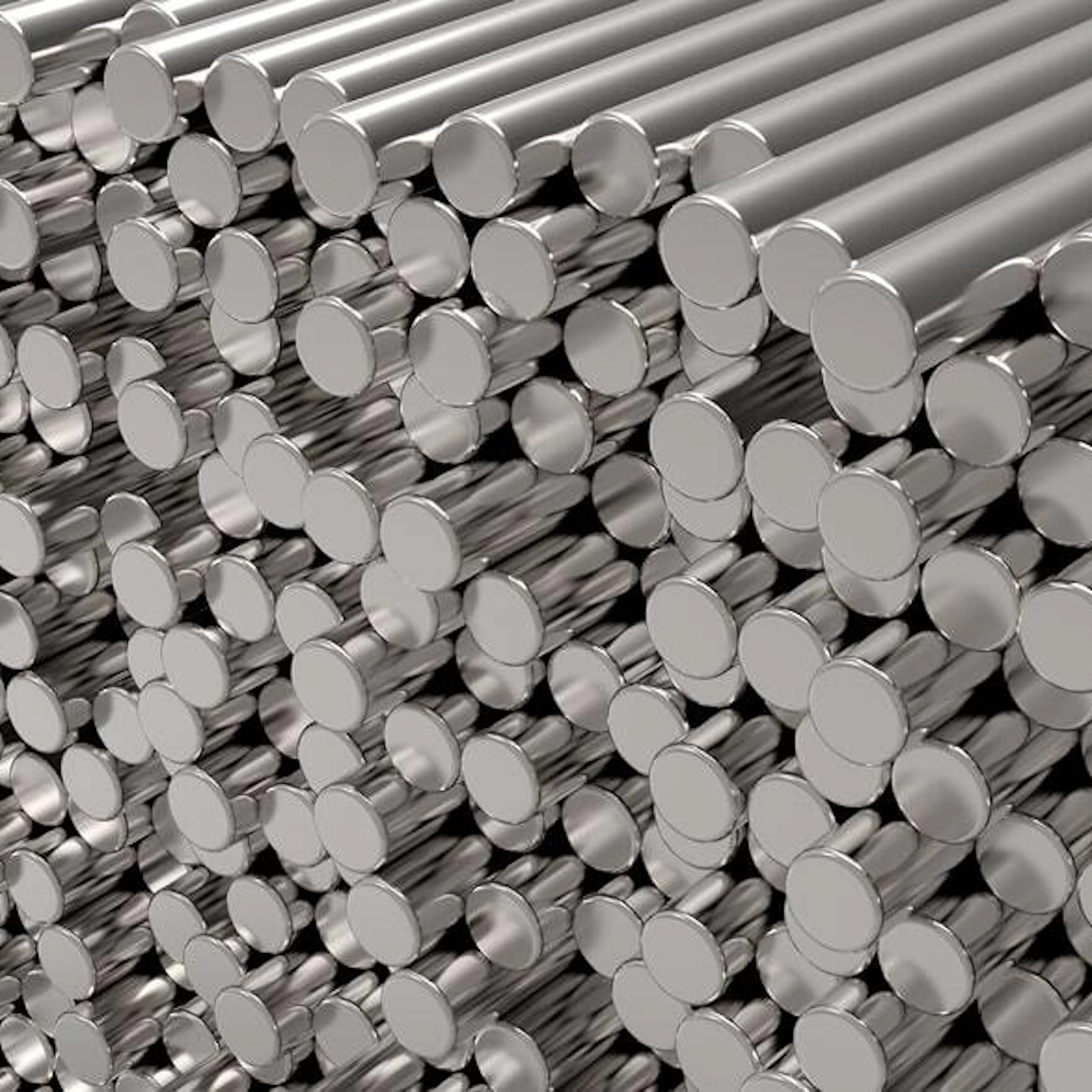

Round metal bars stacked. Image Credit: Shutterstock.com/rimira

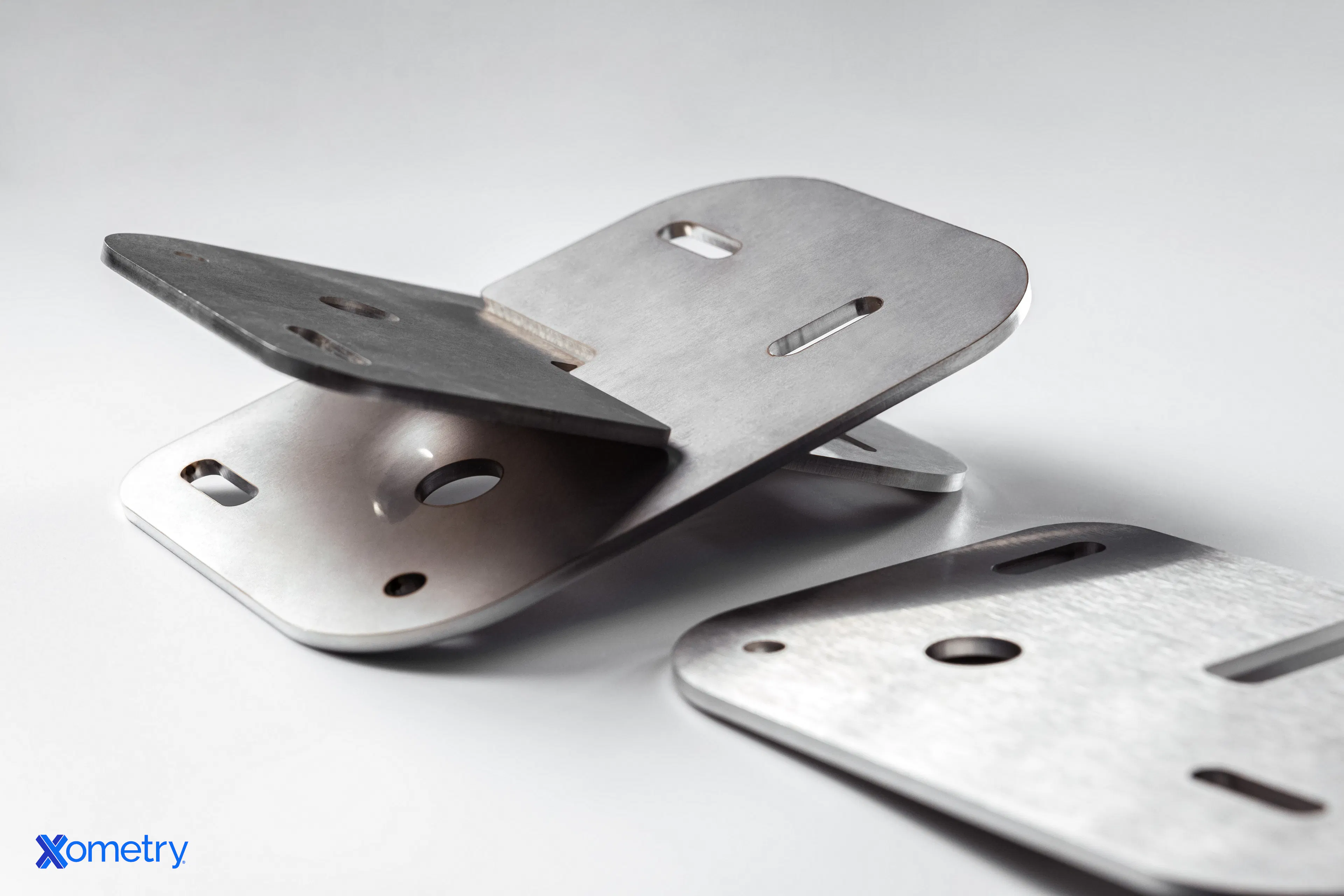

Aluminum sheet metal plates
