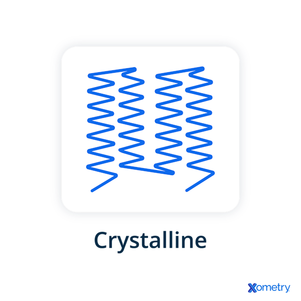

What Is a Crystalline Polymer?
A crystalline polymer is a type of long-chain organic material characterized by the presence of lamellae, which are ordered zones of aligned molecular chains. Crystalline polymers have highly structured regions and can, in some cases, be entirely composed of a single crystal aligned along one axis. The degree of crystallinity and mutual alignment is highly affected by the crystallization process, which can be triggered and driven by a variety of mechanisms.
You can, for example, heat-treat a polymer component by holding it at a temperature between the glass transition temperature (Tg) and the melting point to let its molecules shift and crystallize. This can be a very slow process. It is difficult to maintain dimensional stability this way for extended periods, so this method typically only gives you a limited degree of molecular alignment.
Some polymers naturally “drift” towards crystallization over time. High molecular motility and elevated temperatures can induce this, resulting in either progressive strengthening or embrittlement.
By controlling the flow of liquid polymer in the manufacturing process, you can influence local and bulk crystallization. A restricted outlet for the molten polymer can generate highly crystalline material. This can create a uniaxial high-strength region that can, for example, be used as a living hinge. Extrusion of polymer can induce molecular alignment, driving a generalized change that makes the material stronger on the primary axis. Extension can similarly align molecule chains. Such extension can be uniaxial (simple stretching), biaxial (X and Y axis combined stretching), or essentially annular (such as when vacuum-forming a dome). These result in differing forms of molecular alignment.
An illustration of a crystalline structure.
