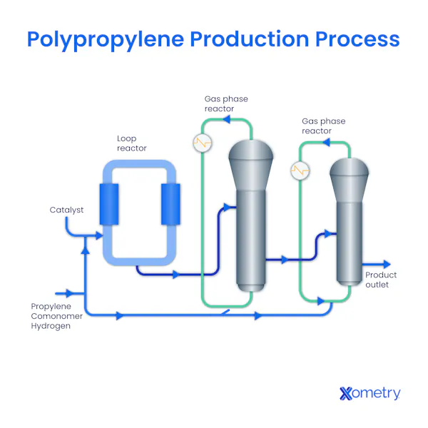

How is Polypropylene Made?
Polypropylene is produced through a controlled polymerization process that transforms propylene gas into a versatile thermoplastic. The method begins with the polymerization of propylene gas using Ziegler-Natta or metallocene catalysts, which initiate the formation of long molecular chains. The reaction creates a semi-crystalline structure that supports mechanical strength and chemical resistance. The resulting polypropylene polymerization yields a material that is shaped into films, fibers, and molded components through processes such as extrusion, injection molding, or blow molding. The flexibility of the polypropylene process enables manufacturers to tailor polypropylene for various applications, including packaging, automotive parts, textiles, and consumer goods. The answer to the question “How is polypropylene made?” reflects a scalable and efficient production method that supports high-volume applications across multiple industries.
Polypropylene production process

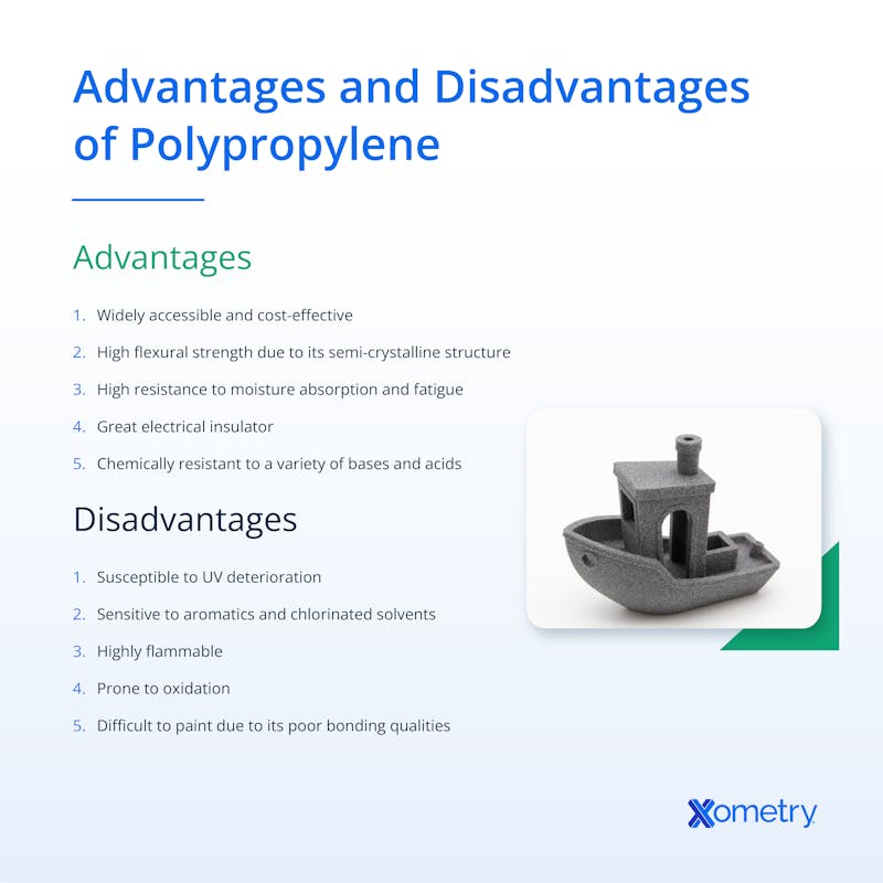

What Are the Advantages of Polypropylene?
The Advantages of Polypropylene are listed below.
  • Polypropylene is produced at a relatively low cost, which supports high-volume manufacturing without compromising material quality. The economic benefits make it suitable for both disposable goods and durable components.
  • The polymer is reprocessed and reused, which supports sustainability efforts in industrial and consumer sectors. Its recyclability reduces waste and promotes circular production models.
  • Polypropylene maintains stability at processing temperatures between 160°C and 170°C, which supports molding and extrusion operations. The thermal behavior allows its use in applications requiring moderate heat exposure without deformation.
What Are the Disadvantages of Polypropylene?
The Disadvantages of Polypropylene are listed below.
  • Prolonged exposure to ultraviolet light weakens polypropylene’s molecular structure, leading to brittleness and discoloration. The polypropylene issues restrict its use in outdoor applications without the addition of stabilizing additives.
  • Polypropylene is highly flammable and supports combustion once ignited. The characteristic limits its suitability in environments where fire resistance is a critical requirement.
  • Polypropylene lacks the mechanical robustness needed for high-load or structural components, while it offers good strength for general applications. The limitation reduces its effectiveness in industrial or high-stress settings where stronger materials are necessary.
Polypropylene Advantages and Disadvantages Infographic
