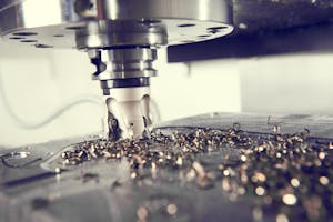

Computer Numerical Controlled (CNC) Machining is a means to remove material using high speed, precision machines that use a wide variety of cutting tools to create the final design. Common CNC machines include vertical milling machines, horizontal milling machines, and lathes.
To successfully make a part on a CNC Machine, programs instruct the machine how it should move. The programmed instructions given to the CNC machine are encoded using CAM (computer aided manufacturing) software in conjunction with the CAD (computer aided design) model provided by the customer. The CAD model is loaded into the CAM software and tool paths are created based on the required geometry of the manufactured part. Once the tool paths are determined, the CAM software creates machine code that tells the machine how fast to move, how fast to turn the stock and/or tool, and where to move in a 5-axis X, Y, Z, A and B coordinate system.
Complex cylindrical shapes can be manufactured more cost effectively using a CNC lathe versus a 3 or 5-axis CNC milling machine. With a CNC lathe, the part stock turns while the cutting tools remain stationary. Conversely, on a CNC mill, the cutting tools move while the stock remains fixed. To create the geometry of a part, the CNC computer controls the rotational speed of the stock as well as the movement and feed rates of the stationary tools. If square features are needed on an otherwise round part, the round geometry is first created on the CNC lathe followed by the square features on a CNC mill.
Because the computer controls the machine movement, the X, Y, and Z axes can all move simultaneously to create everything from simple straight lines to complex geometric shapes. However, despite advancements in tooling and CNC controls, some limitations do still exist in CNC Machining and not all shapes and features can be created. These limitations will be discussed in this guide.
Vertical Milling Machine in Action
Vertical milling machine in action

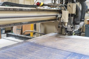

CNC Tooling
CNC tooling

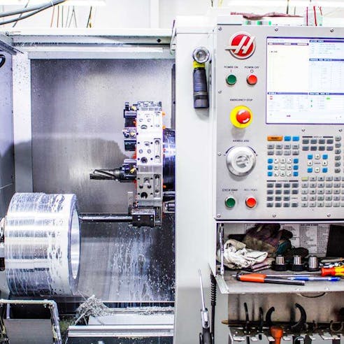

Lathe
Back to top
Xometry’s lathe capabilities allows for successful machining of parts up to 18” (457.2mm) in diameter, but special cases may be made for larger parts. Xometry is capable of utilizing a live tooling lathe, which dramatically decreases lead times and increases the amount of features that can be machined.
Lathe size limitations

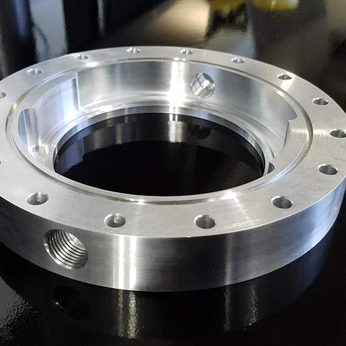

Plastics and softer metals (e.g. aluminum and brass) in general machine easily and subsequently require less machine time, reducing the cost of machining. Harder materials like stainless steel and carbon steel must be machined with slower spindle RPMs and machine feed rates which makes for longer cycle times over the softer materials. As a baseline estimate, aluminum will machine about 4 times faster than carbon steel, and stainless steel will machine half as fast as carbon steel.
Material type is also a critical driver in determining the overall cost of a part. For example, 6061 aluminum bar stock is approximately 1/2 the price of aluminum plate per pound, and 7075 aluminum bar stock can be 2 to 3 times the cost of 6061 bar stock. 304 stainless steel costs about 2 to 3 times as much as 6061 aluminum and about 2 times as much as 1018 carbon steel. Depending on the size and geometry of a part, the material cost can be a significant portion of its overall price. If the design does not warrant the properties of a more expensive material like carbon or stainless steel, consider choosing a less expensive material like 6061 aluminum to minimize material cost.
Circular CNC Machined part made of metal
Red anodized CNC Machined part made of metal
5-axis CNC Machined part made of metal
Metal CNC parts

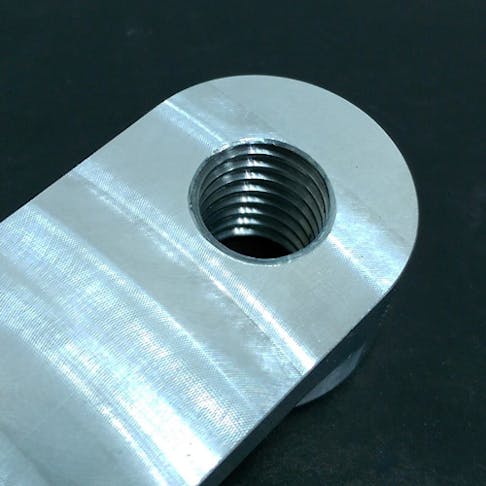

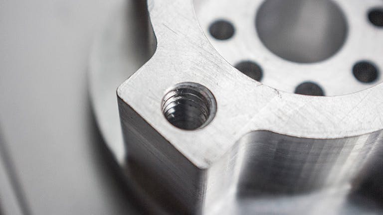

There are several ways to create threads in a part: cut taps, form taps, or thread mills. All of these methods are effective, but designers should keep the following in mind:
  • Always choose the largest thread size possible allowed by the design—it makes the manufacturing process easier.
  • The smaller the tap, the greater the chance it will break during production.
  • Only thread to the length necessary. Deep threaded holes can increase part cost as specialized tooling may be needed to meet the depth requirements. Try to use off-the-shelf thread sizes wherever possible to keep costs down.
  • Be sure to add threads to your quote and attach a specified drawing, or else parts will be machined to the specified diameter.
Note: For a full list of standard thread sizes and constraining geometries recommended by Xometry, click here.
A threaded hole in a CNC part
A threaded hole on a machined part
