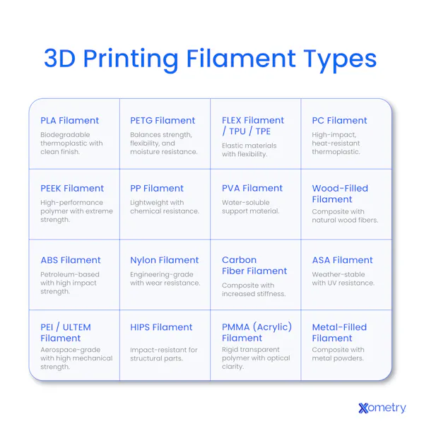

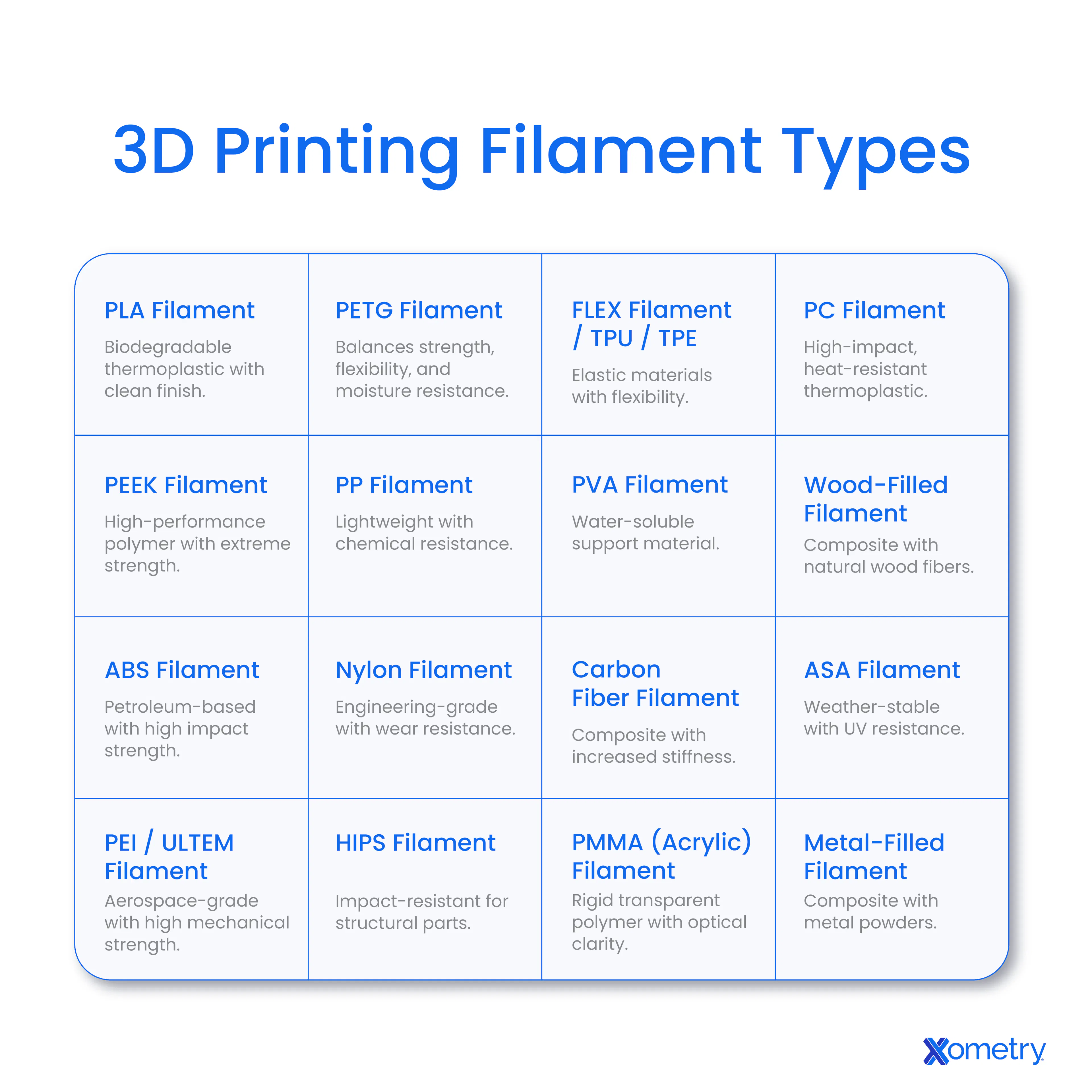

The 26 types of 3D printer filament represent a broad range of materials used in FDM three-dimensional printing through heated extrusion and controlled layer stacking under the category of types of 3d printer filament. Filament feeds from a spool into the extruder, softens in the heated hotend, and forms each layer through controlled deposition until the object reaches full geometry. Filament type selection depends on part function, mechanical load requirements, surface finish expectations, and environmental exposure across different types of 3d printer filament. The breakdown presents defined properties, advantages, and limitations to support accurate material selection for specific project requirements.
The 26 types of 3D printer filament are listed below.
- PLA Filament: Polylactic Acid (PLA) filament is a biodegradable thermoplastic derived primarily from plant-based sources that delivers a clean surface finish, low warp behavior, and stable extrusion for visual models and prototypes.
- ABS Filament: Acrylonitrile Butadiene Styrene (ABS) filament is a petroleum-based thermoplastic that delivers high impact strength, heat resistance, and structural durability for functional mechanical parts.
- PETG Filament: Polyethylene Terephthalate Glycol (PETG) filament is a chemically stable thermoplastic that balances strength, flexibility, and moisture resistance for containers and durable prints.
- Nylon Filament: Nylon filament is an engineering-grade polyamide material that delivers high wear resistance, toughness, and thermal stability for mechanical components.
- FLEX Filament / TPU / TPE: Thermoplastic Polyurethane (TPU) and Thermoplastic Elastomer (TPE) filaments are elastic materials that deliver flexibility, abrasion resistance, and vibration dampening.
- Carbon Fiber Filament: Carbon fiber filament is a composite material that blends chopped carbon fibers with a thermoplastic base to increase stiffness and dimensional stability.
- PC Filament: Polycarbonate (PC) filament is a high-impact, heat-resistant thermoplastic used for industrial enclosures and moderately load-bearing parts.
- ASA Filament: Acrylonitrile Styrene Acrylate (ASA) filament is a weather-stable thermoplastic that delivers UV resistance, heat stability, and outdoor durability.
- PEEK Filament: Polyether Ether Ketone (PEEK) filament is a high-performance polymer that delivers extreme tensile strength, chemical resistance, and sustained high-temperature stability.
- PEI / ULTEM Filament: Polyetherimide (PEI) filament, widely known as ULTEM, is an aerospace-grade thermoplastic with high mechanical strength, flame resistance, and thermal stability.
- PP Filament: Polypropylene (PP) filament is a lightweight polymer that delivers chemical resistance, fatigue resistance, and extremely low water absorption.
- HIPS Filament: High Impact Polystyrene (HIPS) filament is an impact-resistant structural parts used for as dissolvable support with ABS in limonene.
- PVA Filament: Polyvinyl Alcohol (PVA) filament is a water-soluble support material that enables clean removal of internal structures from complex printed models.
- PMMA (Acrylic) Filament: Polymethyl Methacrylate (PMMA) filament is a rigid transparent polymer that delivers high optical clarity and UV resistance for display parts.
- Wood-Filled Filament: Wood-filled filament is a composite material that blends thermoplastic with natural wood fibers to create organic texture and grain appearance.
- Metal-Filled Filament: Metal-filled filament is a composite material that combines thermoplastic with metal powders to produce dense prints with metallic weight and surface finish.
- Ceramic-Filled Filament: Ceramic-filled filament is a composite material that blends thermoplastic with ceramic particles to produce a stone-like surface texture, which achieves ceramic hardness only after kiln firing.
- Silk PLA Filament: Silk PLA filament is a modified PLA material that delivers high surface reflectivity and smooth visual sheen for decorative prints.
- PLA+ Filament: Polylactic Acid Plus (PLA+) filament is an improved PLA formulation that improves impact resistance, layer bonding, and brittleness control.
- Foaming PLA / LW-PLA: Lightweight Polylactic Acid (LW-PLA) filament is a foaming PLA material that expands during extrusion to create low-density lightweight printed structures.
- Glow-in-the-Dark Filament: Glow-in-the-dark filament is a phosphorescent composite material that absorbs light and emits visible glow under low-light conditions.
- Magnetic Filament: Magnetic filament weakly responds to magnets; does not retain magnetism.
- Conductive PLA Filament: Conductive PLA filament is a carbon-infused PLA material that enables low-voltage electrical signal transfer.
- Support Filaments (Soluble Supports): Soluble support filaments are water-dissolvable or solvent-dissolvable materials used for internal support removal during post-processing.
- Nylon-Carbon Fiber Filament: Nylon carbon fiber filament is a composite material that combines nylon polymer with carbon reinforcement for extreme stiffness and strength.
- TPU Filament: Thermoplastic Polyurethane (TPU) filament is a flexible elastomer that delivers high abrasion resistance, elastic recovery, and chemical stability for impact-resistant parts.

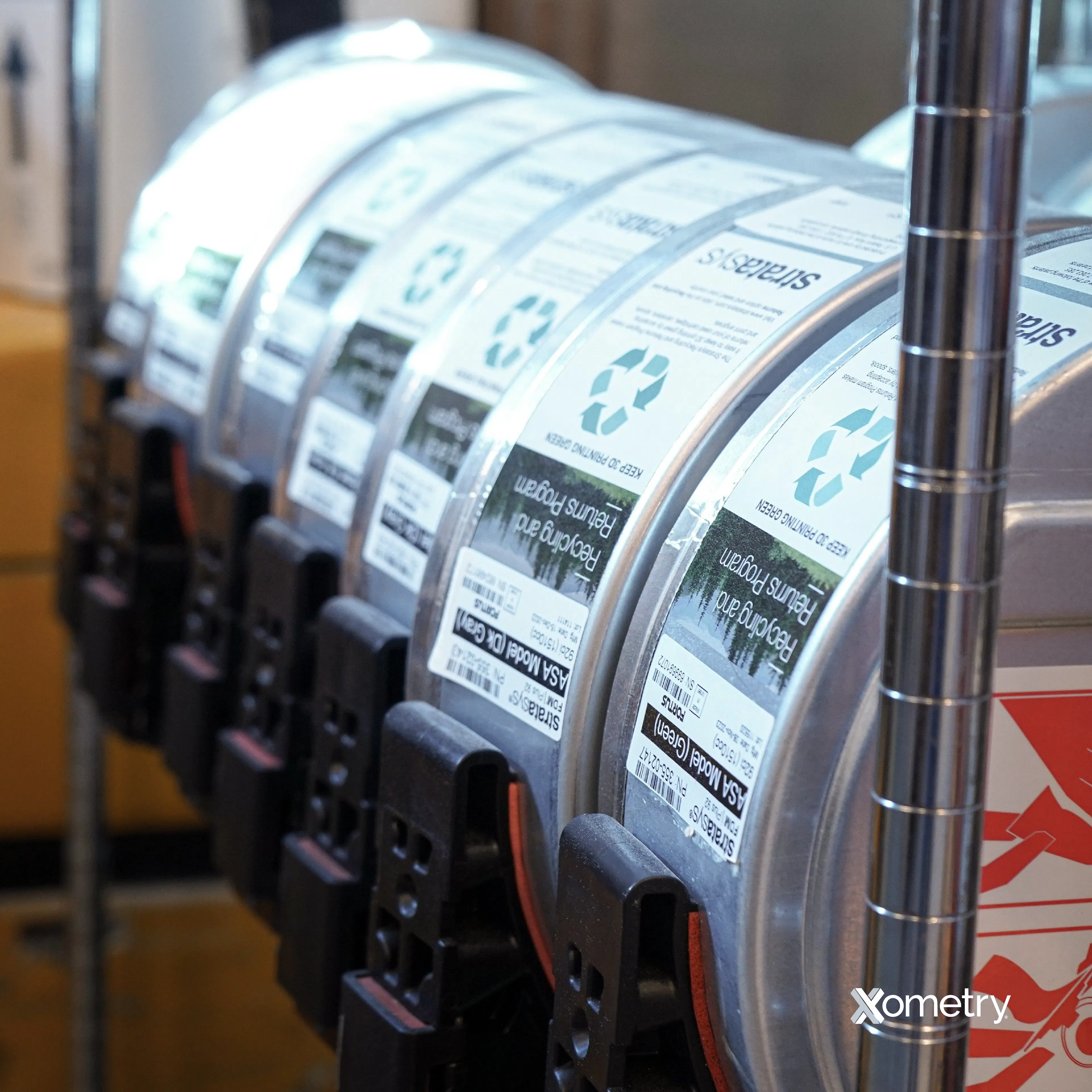

8. ASA Filament
Acrylonitrile styrene acrylate (ASA) filament is a durable thermoplastic known for its superior UV resistance and weatherability compared to other materials like acrylonitrile butadiene styrene (ABS). ASA filament is similar to ABS in strength and toughness but outperforms ABS in outdoor applications due to its superior UV and weather resistance. ASA offers good chemical resistance and withstands high temperatures. ASA tends to warp less and produces fewer fumes during printing, while it prints similarly to ABS. The properties make ASA filament an excellent choice for projects requiring strength and longevity in outdoor environments.
The properties/characteristics of ASA Filament are shown in the table below.
| Property / Characteristic | Typical Value or Description (ASA Filament) |
Property / Characteristic Density | Typical Value or Description (ASA Filament) 1.08-1.09 g/cm³ |
Property / Characteristic Glass Transition Temperature | Typical Value or Description (ASA Filament) 98-112 °C depending on formulation and testing method. |
Property / Characteristic Shrinkage Rate | Typical Value or Description (ASA Filament) Moderate shrinkage requires a heated bed for dimensional stability. |
Property / Characteristic UV Resistance | Typical Value or Description (ASA Filament) High, retains color and structural integrity under prolonged sunlight exposure. |
Property / Characteristic Moisture Absorption | Typical Value or Description (ASA Filament) Low hygroscopic tendency. less sensitive to moisture compared with some engineering plastics. |
Property / Characteristic Surface Finish | Typical Value or Description (ASA Filament) Smooth, weather-resistant surface suited for outdoor and aesthetic parts. |
Property / Characteristic Odor Level | Typical Value or Description (ASA Filament) Moderate during printing, similar to but less intense than ABS. |
Property / Characteristic Biodegradability | Typical Value or Description (ASA Filament) Non-‘biodegradable, thermoplastic polymer stable under normal conditions. |
Property / Characteristic Recommended Nozzle Type | Typical Value or Description (ASA Filament) Standard FFF/FDM nozzle capable of 240-260 °C extrusion, heated bed (90-110 °C) recommended. |
Property / Characteristic Recommended Use Cases | Typical Value or Description (ASA Filament) Outdoor parts, automotive components, enclosures, functional prototypes, and parts needing UV/weather resistance. |
Property / Characteristic Cost Level | Typical Value or Description (ASA Filament) Higher than basic filaments (PLA, PETG) due to improved performance and printing requirements. |
Property / Characteristic Print Speed Compatibility | Typical Value or Description (ASA Filament) Typical print speeds, some ASA brands recommend moderate speed (30-50 mm/s) for reliable results |
Property / Characteristic Layer Adhesion | Typical Value or Description (ASA Filament) Good adhesion when printing temperature, bed temperature, and ambient conditions are well controlled |
Property / Characteristic Post-Processing Compatibility | Typical Value or Description (ASA Filament) Suitable for sanding, painting, vapor smoothing, tolerates outdoor environmental exposure |
Property / Characteristic Food-Safe Potential | Typical Value or Description (ASA Filament) Limited, suitability depends on specific formulation and manufacturer certification. |
