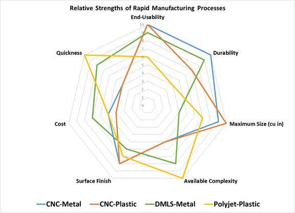

I am going to start this long conversation with a very simple graph with the relative strengths and weaknesses of a given process. Please keep in mind that this is a generalization and there is some wiggle room for each method – but this graph can still serve as a guide.
Slide 1 of 1
Figure 1. The Relative Strengths of Rapid Manufacturing by Process.
Part designers have many constraints but there are a couple that usually scream out as a priority. For example, if I need a complex part quickly I may look at Polyjet-plastic options; however, this may also mean I am sacrificing a certain level of end-usability or durability. Another example may be where I just need a large, simple fixture to hold parts in place for an assembly job over a month away. In this example I would likely look at CNC-metal or CNC-plastic; these processes has a longer lead times to make but will likely be the most economical option. Some of the Polyjet-plastic materials, such as ABS-like, have high strength and some flex which allows them to substitute for rigid fixture parts so if your requirements are slightly changed – such as an expedited lead time.
