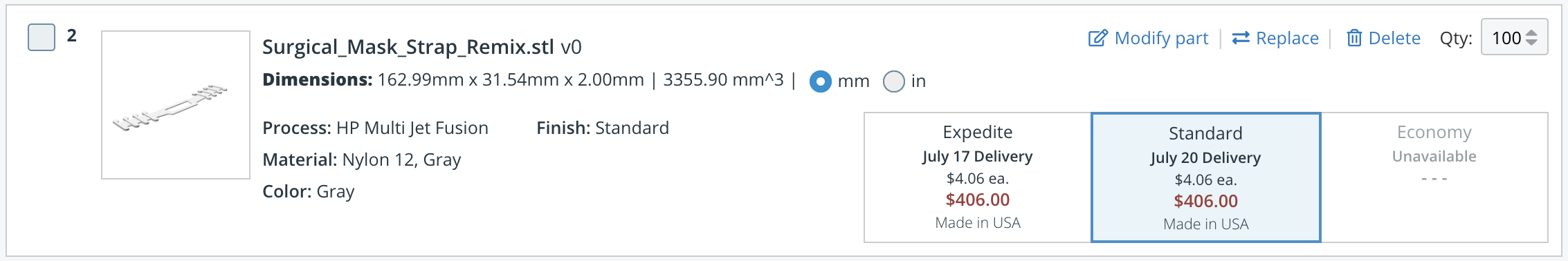

Especially for parts made with selective laser sintering (SLS) and HP Multi Jet Fusion (MJF), these parts are cheap enough to scale. For example, a surgical mask strap made with MJF is very affordable at a few dollars per part. The part is the same cost whether you are ordering 100 or 1,000 parts, so you know exactly what your costs will be at any given time.
With a mold, the tool may cost a few thousand dollars upfront, requiring you to hit a certain output of parts to amortize the tooling cost. For example, a tool that costs $5,000 will require a run quantity of 1,232 units to achieve the same economy of scale. Beyond this break-even point, injection molding will typically be the more affordable option, but will always require you to commit upfront to tooling creation and costs. If you are not sure whether you will create enough parts to amortize the cost of the tool, 3D printing production can provide you with the flexibility to make decisions about your product quantity later.
